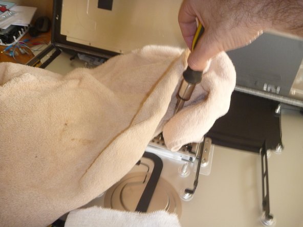

      • For the final step to remove the logic board, I found a flexible shaft (pic 3 - sorry it's blurry, shooting left handed) almost a necessity, as I couldn't get a straight shaft screwdriver in position and develop enough torque to loosen the screws.

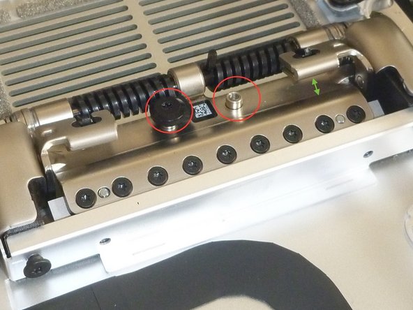

      • The screws circled in red maintain the pressure on the coil springs in the stand. If you can maneuver the iMac relative to the stand such that the gap highlighted by the green arrow (pic2) closes all the way, then pressure from the coil springs will be removed from the external part of the stand.
      • I couldn't do that, so I removed these screws to release the pressure between the internal and external part of the stand.
      • NOTE: once the screw is released, the coil spring will launch the plastic piece and screw that hold the spring! (It took me quite a while to find the first one.) I highly recommend covering the screw with something (pic3) as you remove the screw.

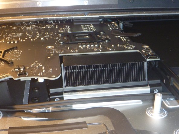

      • I just took a couple of pictures with no stand attached, in case they help someone.

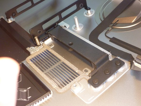

      • I noticed that the new adaptor doesn't quite fit in my version of the 27in iMac (late 2013 version). With the hard drive bracket in the position where it should be (indicated by arrow), the new adaptor bumps into the bracket (in area circled).
      • So I made a small modification to the new adaptor with a metal file.
      • Picture with modified adaptor (VESA mount) in place (the red circle around the modification).

      • Two pics from various angles of the new mount in place. One pic after the logic board has been reinstalled.

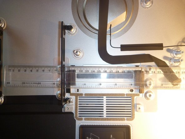

For makers it would be great to know the hole pattern so one could make a part and not relay an someone to sell it.
There are 9 screws and 2 pins. What size and distance do the holes have relative to each other. Would be great to get this information from someone who took his iMac apart.
