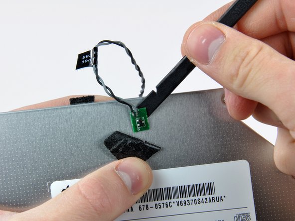

    • Use the tip of a spudger to peel back the piece of foam tape covering the optical drive thermal sensor.
    • Use the flat end of a spudger to carefully pry the thermal sensor up off the adhesive securing it to the optical drive.
    • If you have a disc or anything else stuck inside your optical drive, we have a guide to fix it.
