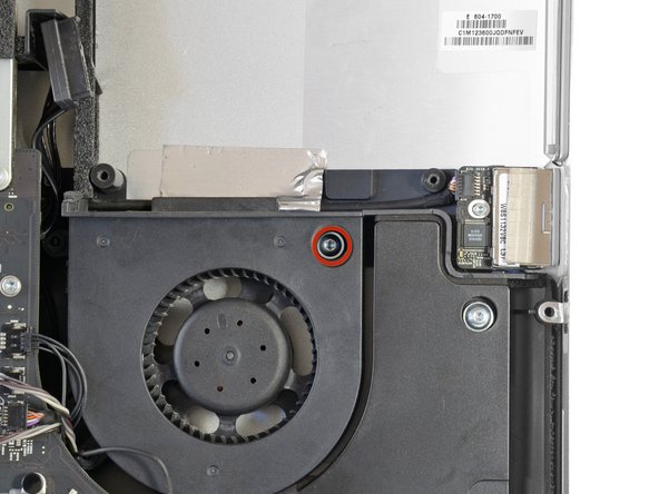

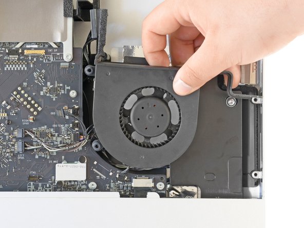

    1. iMac Intel 27" EMC 2429 Optical Drive Fan Replacement, Optical Drive Fan: crwdns2935265:015crwdnd2935265:01crwdnd2935265:03crwdne2935265:0 iMac Intel 27" EMC 2429 Optical Drive Fan Replacement, Optical Drive Fan: crwdns2935265:015crwdnd2935265:02crwdnd2935265:03crwdne2935265:0 iMac Intel 27" EMC 2429 Optical Drive Fan Replacement, Optical Drive Fan: crwdns2935265:015crwdnd2935265:03crwdnd2935265:03crwdne2935265:0
      • Use the flat end of a spudger to pull the optical drive fan connector out of its socket.
      • Remove the T10 Torx screw securing the optical drive fan to the iMac case.
      • Remove the fan by pulling it straight away from iMac case, being careful not to let its cable get caught on any other cables or components.
