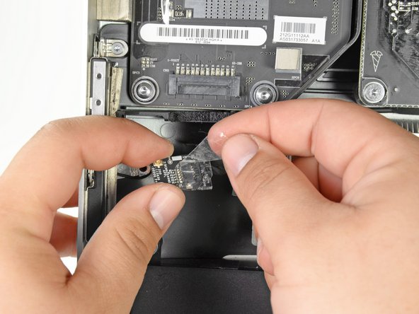

    • Remove the T8 Torx screw securing the Bluetooth board to the case.
    • Do not attempt to completely remove the board yet, as it is still attached by a cable.
    • Remove the tape wrapped around the Bluetooth board, being careful not to put to much tension on the still connected cable.
    • Use the flat end of a spudger to pull the Bluetooth data cable out of its connector and remove the Bluetooth board.
