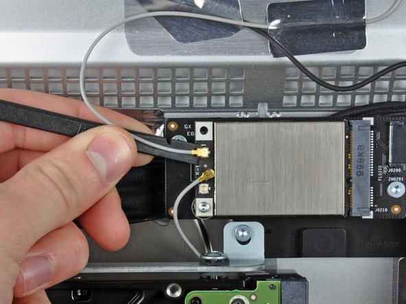

  10. iMac Intel 27" EMC 2309 and 2374 AirPort Card Replacement, AirPort Card: crwdns2935265:010crwdnd2935265:01crwdnd2935265:02crwdne2935265:0 iMac Intel 27" EMC 2309 and 2374 AirPort Card Replacement, AirPort Card: crwdns2935265:010crwdnd2935265:02crwdnd2935265:02crwdne2935265:0
    • Use the flat end of a spudger to pry both AirPort antenna cable connectors up off the AirPort card.
  11. iMac Intel 27" EMC 2309 and 2374 AirPort Card Replacement: crwdns2935265:011crwdnd2935265:01crwdnd2935265:01crwdne2935265:0
    • Remove the single T6 Torx screw securing the AirPort card to its interconnect board.
    • After removing this screw, the free end of the AirPort card should lift slightly.
  12. iMac Intel 27" EMC 2309 and 2374 AirPort Card Replacement: crwdns2935265:012crwdnd2935265:01crwdnd2935265:01crwdne2935265:0
    • Pull the AirPort card away from its socket and remove it from the iMac.
