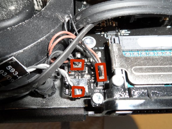

  3. iMac Intel 24" EMC 2267 Graphics Card Replacement: crwdns2935265:03crwdnd2935265:01crwdnd2935265:03crwdne2935265:0 iMac Intel 24" EMC 2267 Graphics Card Replacement: crwdns2935265:03crwdnd2935265:02crwdnd2935265:03crwdne2935265:0 iMac Intel 24" EMC 2267 Graphics Card Replacement: crwdns2935265:03crwdnd2935265:03crwdnd2935265:03crwdne2935265:0
    • This position on the logic board has three closely-spaced connectors for the power button, ambient temp sensor, and the CPU fan. Unplug them.
    • Disconnect these three connectors for the HD temp sensor, optical drive temp sensor, and hard drive fan.
    • Each one of these three connectors has a different number of pins so you can't mix them up when reconnecting. Thanks, Apple!

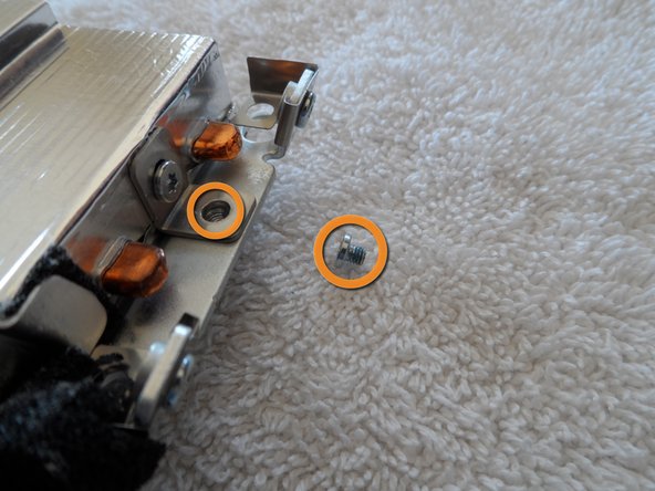

  10. iMac Intel 24" EMC 2267 Graphics Card Replacement: crwdns2935265:010crwdnd2935265:01crwdnd2935265:03crwdne2935265:0 iMac Intel 24" EMC 2267 Graphics Card Replacement: crwdns2935265:010crwdnd2935265:02crwdnd2935265:03crwdne2935265:0 iMac Intel 24" EMC 2267 Graphics Card Replacement: crwdns2935265:010crwdnd2935265:03crwdnd2935265:03crwdne2935265:0
    • The graphics card is retained by two T-9 (2mm x 5mm) torx screws on the GPU board...
    • a third T-9 (2mm x 4mm) screw on the end of the heat sink...
    • and the ever-present thermal sensor connector.
    • Remove/disconnect them all.

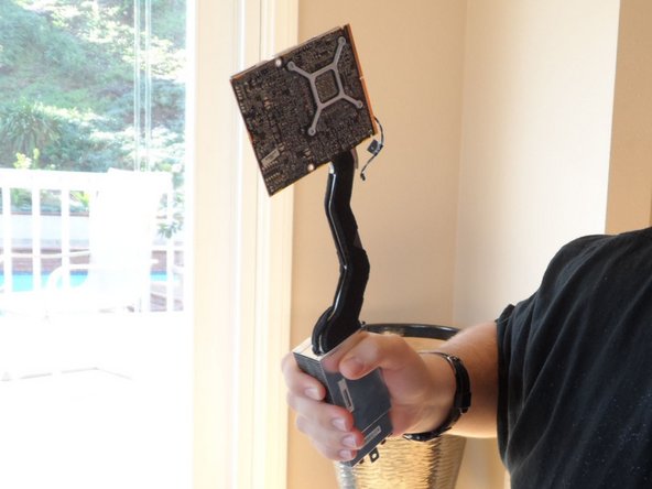

    • You've done it! The graphics card simply tilts up 45 degrees and slides up out of the MXM connector, heat sink and all. I'm glad I could see just how well engineered this piece of Apple hardware is.
    • In the second photo you can see the replacement graphics card (Apple part #661-5135) I got from Impact Computers in Florida. It's a drop-in replacement. Even the adhesive foam and thermal sensor are already in place. In fact, you better not turn your back or you may forget which is which!
    • You World of Warcraft players out there might agree my son and I thought the old video card makes a pretty authentic-looking Gnomish 1H axe. Glory to the Alliance! :-)
