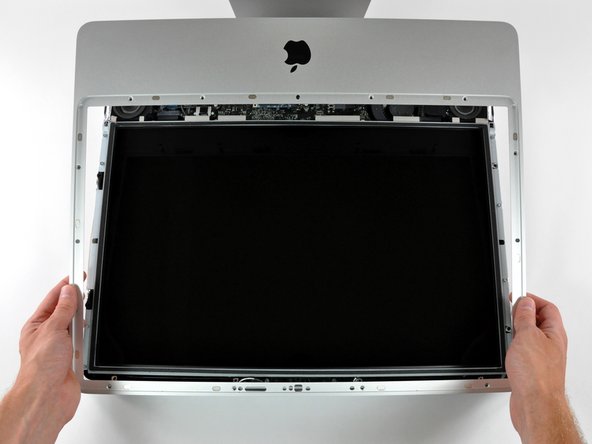

  4. iMac Intel 24" EMC 2267 Front Bezel Replacement, Note - most of this guide was taken from the info for: iMac Intel 20" EMC 2266: crwdns2935265:04crwdnd2935265:01crwdnd2935265:01crwdne2935265:0
    • Remove the following 12 screws securing the front bezel to the rear case:
    • bottom centre two are long (26mm)
    • four on sides (two left, two right) are medium (18mm)
    • and the remaining six (four top, two bottom corners) are short (14mm).
  5. iMac Intel 24" EMC 2267 Front Bezel Replacement: crwdns2935265:05crwdnd2935265:01crwdnd2935265:02crwdne2935265:0 iMac Intel 24" EMC 2267 Front Bezel Replacement: crwdns2935265:05crwdnd2935265:02crwdnd2935265:02crwdne2935265:0
    • The front bezel is still attached to the iMac by the microphone cable.
    • Gently lift the front bezel from its top edge off the rear case.
    • Once the top edge of the front bezel has cleared the rear case, rotate the front bezel toward the stand and lift it off the rear case.
    • Rotate the front bezel away from the rest of the device and lay it above the top edge of the iMac.
    • When reinstalling the front bezel, start at the lower edge and make sure it is flush with the rear case before lowering the top edge onto the iMac.
  6. iMac Intel 24" EMC 2267 Front Bezel Replacement: crwdns2935265:06crwdnd2935265:01crwdnd2935265:01crwdne2935265:0
    • There is enough length in the microphone cable so that the bezel can be laid on the table above the computer without needing to be disconnected.
    • Disconnect the microphone cable connector, removing tape as necessary.
    • For the front bezel to sit properly, be sure to tuck the microphone cable and connector into the void next to the camera board.
