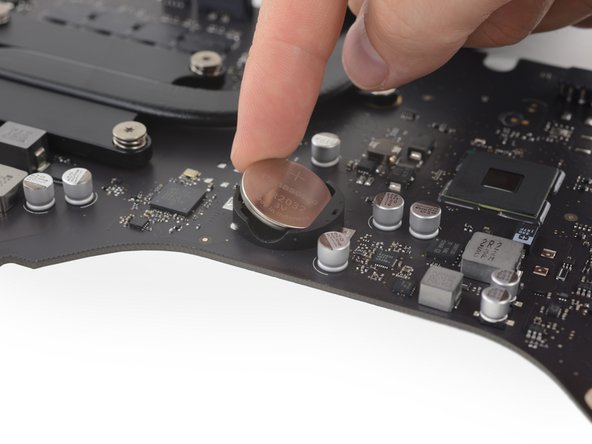

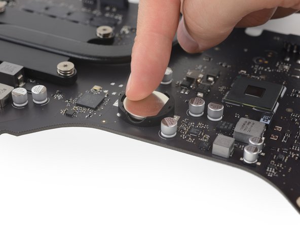

  64. iMac Intel 21.5" Retina 4K Display PRAM Battery Replacement, PRAM Battery: crwdns2935265:064crwdnd2935265:01crwdnd2935265:03crwdne2935265:0 iMac Intel 21.5" Retina 4K Display PRAM Battery Replacement, PRAM Battery: crwdns2935265:064crwdnd2935265:02crwdnd2935265:03crwdne2935265:0 iMac Intel 21.5" Retina 4K Display PRAM Battery Replacement, PRAM Battery: crwdns2935265:064crwdnd2935265:03crwdnd2935265:03crwdne2935265:0
    • The PRAM battery is secured by a spring contact and two small plastic nubs.
    • Gently push the battery away from the two plastic nubs. (This puts increased pressure on the spring contact at the other end.)
    • Once the battery's edge clears the two nubs, tilt it up out of its socket.
  65. iMac Intel 21.5" Retina 4K Display PRAM Battery Replacement: crwdns2935265:065crwdnd2935265:01crwdnd2935265:01crwdne2935265:0
    • Remove the PRAM battery.

Hmm. I don't see a single place in these instruction, including the parts needed list, that tells which battery is required. From one of the photos it looks like BR2032.
Phil McInnis - crwdns2934203:0crwdne2934203:0
As I needed to replace the failing hard drive in my late 2015 21.5" iMac anyway, and the iMac is now nearly 8 years old, I figured I may as well replace the PRAM battery as well since I've got the screen off. The battery must be getting near its end of life anyway, right? And I don't want to have to open this iMac up again anytime soon. And there seems to be no way to tell what its voltage is without taking it out. So after going through this whole process and putting in a new battery (which registered 3.40 volts at installation), I measured the voltage of the old, original battery. 3.19 volts. I guess I could have waited another 8 years at this rate before replacing it! So if this helps anyone - as long as you keep your iMac plugged in, the PRAM battery in these models might last a good 16 years I guess. (I really wish that if they could not provide a way to measure the remaining life span or at least the voltage of the battery, they would have put it on the other side of the logic board!)
By the way, regarding BR2032 vs CR2032: Apple used BR2032 for the PRAM battery on these and many other iMac models, but the BR2032 is much more difficult to get hold of than the CR2032, as well as more expensive. (It's supposed to hold up better under the heat of the environment it's in.) However, I recently had to open a 2009 iMac again, two years after doing some prior work on it: beside the other work I had put in a CR2032 back then. The CR2032 I removed still had 3.14 volts after two full years in the 2009 iMac. So I don't think the CR2032 would hold up as long as a BR2032, but at that rate I suppose it would get at least 4 years of service before dropping too low.
