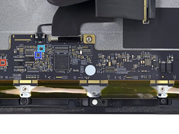

  18. iMac Intel 21.5" Retina 4K Display 2017 Teardown: crwdns2935265:018crwdnd2935265:01crwdnd2935265:03crwdne2935265:0 iMac Intel 21.5" Retina 4K Display 2017 Teardown: crwdns2935265:018crwdnd2935265:02crwdnd2935265:03crwdne2935265:0 iMac Intel 21.5" Retina 4K Display 2017 Teardown: crwdns2935265:018crwdnd2935265:03crwdnd2935265:03crwdne2935265:0
    • Display controller board chip identification, continued:
    • Texas Instruments TMP423 triple remote/local temperature sensor
    • Winbond W25Q40CL 4 MB serial NOR flash memory
    • Texas Instruments TPS3808 current supervisor
    • Ricoh R1154N065B 150 mA LDO regulator
    • Texas Instruments SN74AHC1G08 single 2-input AND gate and SN74LVC1G04 dual inverters
    • Texas Instruments SN74LVC1G98 configurable multiple-function gate
