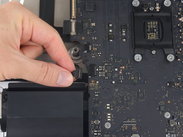

  29. iMac Intel 21.5" Retina 4K Display (2017) Left Speaker Replacement, Left Speaker: crwdns2935265:029crwdnd2935265:01crwdnd2935265:02crwdne2935265:0 iMac Intel 21.5" Retina 4K Display (2017) Left Speaker Replacement, Left Speaker: crwdns2935265:029crwdnd2935265:02crwdnd2935265:02crwdne2935265:0
    • Gently pull the left speaker cable straight out of its socket on the logic board.
  30. iMac Intel 21.5" Retina 4K Display (2017) Left Speaker Replacement: crwdns2935265:030crwdnd2935265:01crwdnd2935265:01crwdne2935265:0
    • De-route the left speaker cable by pulling it straight up out of the retaining clip in the back of the rear enclosure.
  31. iMac Intel 21.5" Retina 4K Display (2017) Left Speaker Replacement: crwdns2935265:031crwdnd2935265:01crwdnd2935265:03crwdne2935265:0 iMac Intel 21.5" Retina 4K Display (2017) Left Speaker Replacement: crwdns2935265:031crwdnd2935265:02crwdnd2935265:03crwdne2935265:0 iMac Intel 21.5" Retina 4K Display (2017) Left Speaker Replacement: crwdns2935265:031crwdnd2935265:03crwdnd2935265:03crwdne2935265:0
    • Use a spudger to disconnect the power button connector from its socket on the logic board.
    • Be careful not to touch any solder joints on the back of the power supply. Capacitors may be charged enough to give you a dangerous shock.

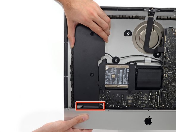

  33. iMac Intel 21.5" Retina 4K Display (2017) Left Speaker Replacement: crwdns2935265:033crwdnd2935265:01crwdnd2935265:02crwdne2935265:0 iMac Intel 21.5" Retina 4K Display (2017) Left Speaker Replacement: crwdns2935265:033crwdnd2935265:02crwdnd2935265:02crwdne2935265:0
    • Lift the left speaker straight up, until the power button cable is exposed (about 0.5").
  34. iMac Intel 21.5" Retina 4K Display (2017) Left Speaker Replacement: crwdns2935265:034crwdnd2935265:01crwdnd2935265:03crwdne2935265:0 iMac Intel 21.5" Retina 4K Display (2017) Left Speaker Replacement: crwdns2935265:034crwdnd2935265:02crwdnd2935265:03crwdne2935265:0 iMac Intel 21.5" Retina 4K Display (2017) Left Speaker Replacement: crwdns2935265:034crwdnd2935265:03crwdnd2935265:03crwdne2935265:0
    • Gently de-route the power button cable from its groove in the left speaker.
  35. iMac Intel 21.5" Retina 4K Display (2017) Left Speaker Replacement: crwdns2935265:035crwdnd2935265:01crwdnd2935265:03crwdne2935265:0 iMac Intel 21.5" Retina 4K Display (2017) Left Speaker Replacement: crwdns2935265:035crwdnd2935265:02crwdnd2935265:03crwdne2935265:0 iMac Intel 21.5" Retina 4K Display (2017) Left Speaker Replacement: crwdns2935265:035crwdnd2935265:03crwdnd2935265:03crwdne2935265:0
    • Lift the left speaker straight up and remove it from the iMac.
