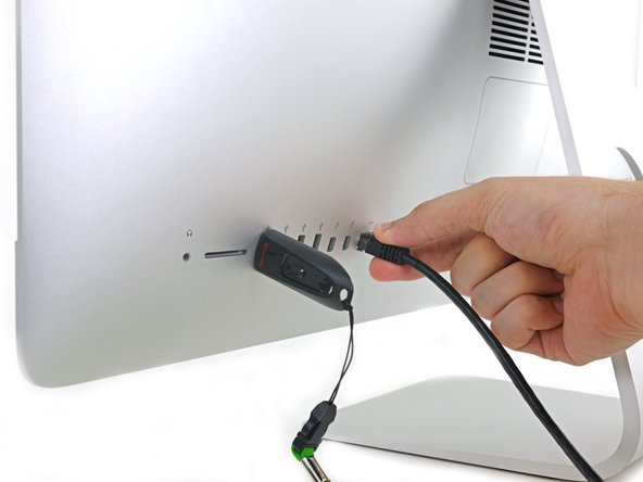

    • Before beginning any work on your iMac: Unplug the computer and press and hold the power button for ten seconds to discharge the power supply's capacitors.
    • Be very careful not to touch the capacitor leads or any exposed solder joints on the back of the power supply. Only handle the board by the edges.

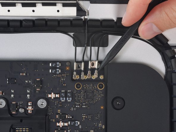

  51. iMac Intel 21.5" Retina 4K Display (2017) CPU Replacement: crwdns2935265:051crwdnd2935265:01crwdnd2935265:01crwdne2935265:0
    • Remove the two 4.0 mm T5 Torx screws securing the four antenna connectors to the AirPort/Bluetooth card.

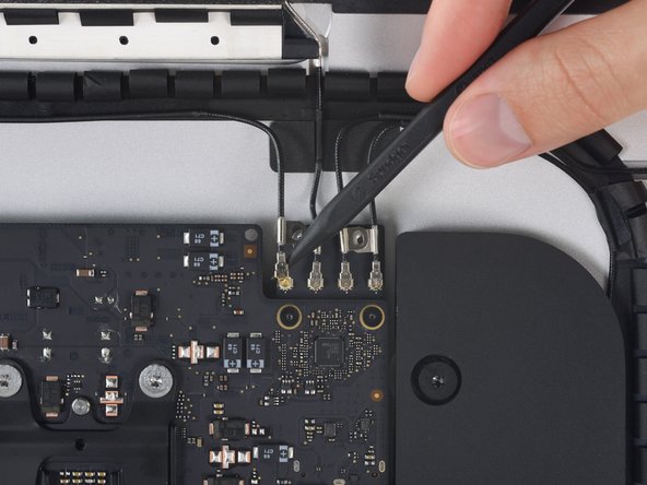

  52. iMac Intel 21.5" Retina 4K Display (2017) CPU Replacement: crwdns2935265:052crwdnd2935265:01crwdnd2935265:03crwdne2935265:0 iMac Intel 21.5" Retina 4K Display (2017) CPU Replacement: crwdns2935265:052crwdnd2935265:02crwdnd2935265:03crwdne2935265:0 iMac Intel 21.5" Retina 4K Display (2017) CPU Replacement: crwdns2935265:052crwdnd2935265:03crwdnd2935265:03crwdne2935265:0
    • Disconnect all four antenna connectors by prying them straight up from their sockets on the AirPort/Bluetooth card.

  60. iMac Intel 21.5" Retina 4K Display (2017) CPU Replacement: crwdns2935265:060crwdnd2935265:01crwdnd2935265:02crwdne2935265:0 iMac Intel 21.5" Retina 4K Display (2017) CPU Replacement: crwdns2935265:060crwdnd2935265:02crwdnd2935265:02crwdne2935265:0
    • When reassembling your iMac, be very careful to align the exterior I/O ports correctly. The logic board can sit crooked even when secured with all its screws.
    • Use a USB flash drive and/or ethernet cable to keep the logic board seated correctly while you tighten the screws.

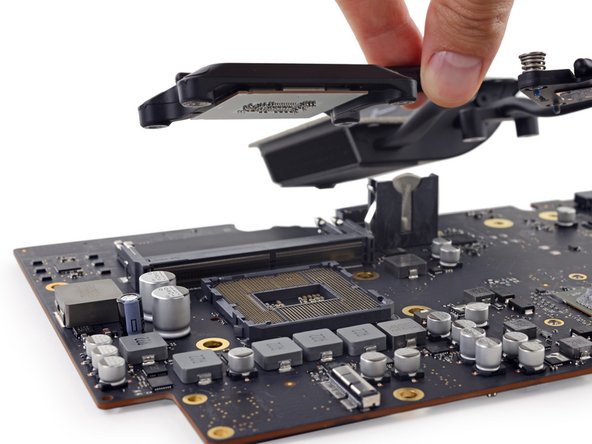

  66. iMac Intel 21.5" Retina 4K Display (2017) CPU Replacement: crwdns2935265:066crwdnd2935265:01crwdnd2935265:02crwdne2935265:0 iMac Intel 21.5" Retina 4K Display (2017) CPU Replacement: crwdns2935265:066crwdnd2935265:02crwdnd2935265:02crwdne2935265:0
    • Note that the CPU will most likely remain stuck to the underside of the heat sink as it's lifted out. Take care not to damage it.
    • Lift and remove the heat sink assembly from the logic board.

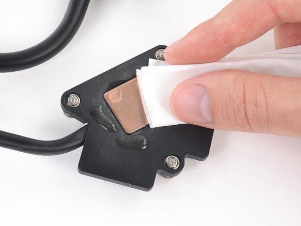

  69. iMac Intel 21.5" Retina 4K Display (2017) CPU Replacement: crwdns2935265:069crwdnd2935265:01crwdnd2935265:02crwdne2935265:0 iMac Intel 21.5" Retina 4K Display (2017) CPU Replacement: crwdns2935265:069crwdnd2935265:02crwdnd2935265:02crwdne2935265:0
    • Use a lint-free cloth (or coffee filter) with either isopropyl alcohol or ArctiClean Thermal Material Remover to thoroughly clean the thermal paste residue from both the CPU and GPU arms of the heat sink.
    • Once the heat sink surfaces are completely clean, use a fresh lint-free cloth or coffee filter to apply a drop of ArctiClean Thermal Surface Purifier to remove any oils and prepare the copper heat sink surfaces.
    • Do not touch the copper surface with your bare fingers, or allow any dust or debris to get on it. Even a fingerprint can be a major obstacle to thermal transfer. If you touch it accidentally, re-clean it and re-apply the surface purifier.
    • Allow the heat sink to dry completely while you continue working.

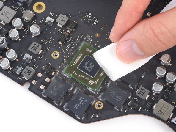

  70. iMac Intel 21.5" Retina 4K Display (2017) CPU Replacement: crwdns2935265:070crwdnd2935265:01crwdnd2935265:02crwdne2935265:0 iMac Intel 21.5" Retina 4K Display (2017) CPU Replacement: crwdns2935265:070crwdnd2935265:02crwdnd2935265:02crwdne2935265:0
    • Use a spudger to gently lift the excess thermal paste residue off of the GPU.
    • As before, use a lint-free cloth or coffee filter and the appropriate fluids to clean and prep the GPU surface.
    • Clean the thermal paste from the four VRAM chips around the GPU as well.

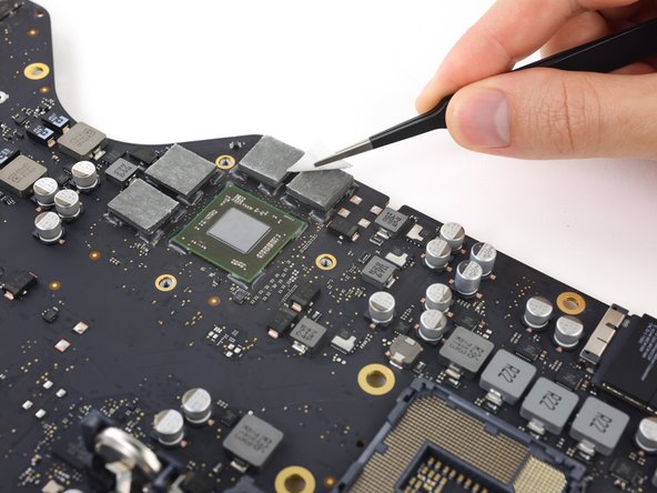

  71. iMac Intel 21.5" Retina 4K Display (2017) CPU Replacement: crwdns2935265:071crwdnd2935265:01crwdnd2935265:02crwdne2935265:0 iMac Intel 21.5" Retina 4K Display (2017) CPU Replacement: crwdns2935265:071crwdnd2935265:02crwdnd2935265:02crwdne2935265:0
    • Apply thermal pads to the four VRAM modules around the GPU.
    • Alternatively, you can use a thick thermal paste such as thermal putty or K5-PRO.
    • Use tweezers to peel the liner from the tops of the thermal pads.

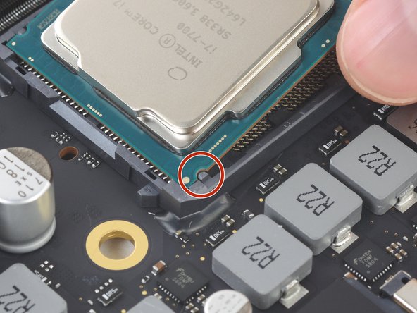

  72. iMac Intel 21.5" Retina 4K Display (2017) CPU Replacement: crwdns2935265:072crwdnd2935265:01crwdnd2935265:02crwdne2935265:0 iMac Intel 21.5" Retina 4K Display (2017) CPU Replacement: crwdns2935265:072crwdnd2935265:02crwdnd2935265:02crwdne2935265:0
    • Check the orientation of your CPU before installing it.
    • Small cutouts on the edges of the CPU align with notches on the sides of the socket.
    • Carefully align your new CPU into its socket on the motherboard, and lay it into position.
