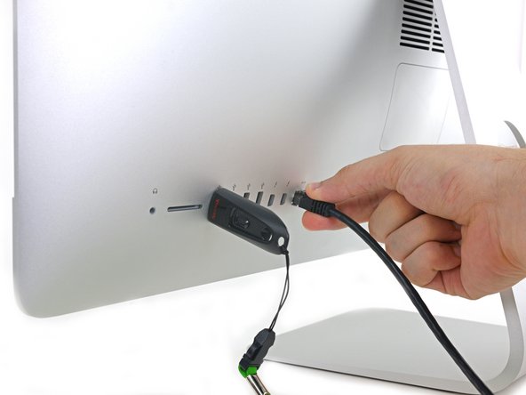

    • Before beginning any work on your iMac: Unplug the computer and press and hold the power button for ten seconds to discharge the power supply's capacitors.

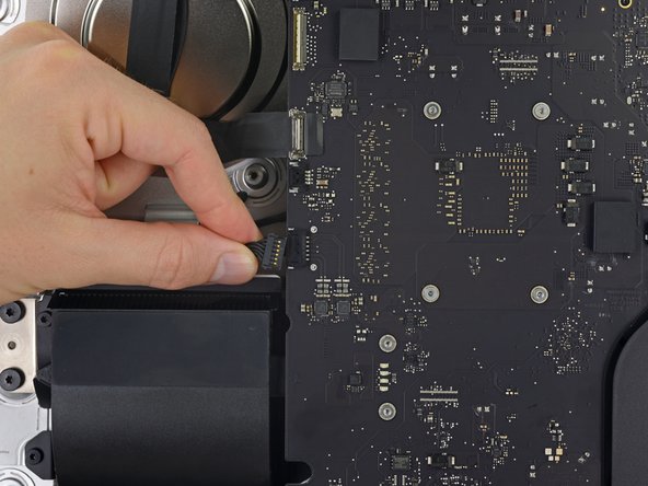

    • Gently pull the fan cable connector straight out of its socket on the logic board.

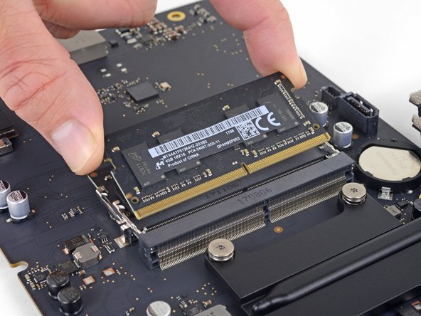

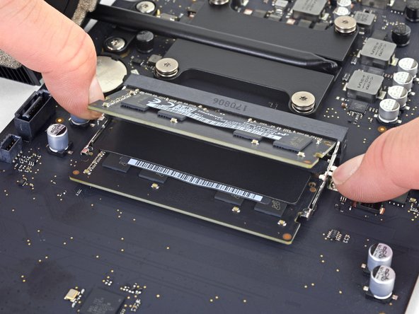

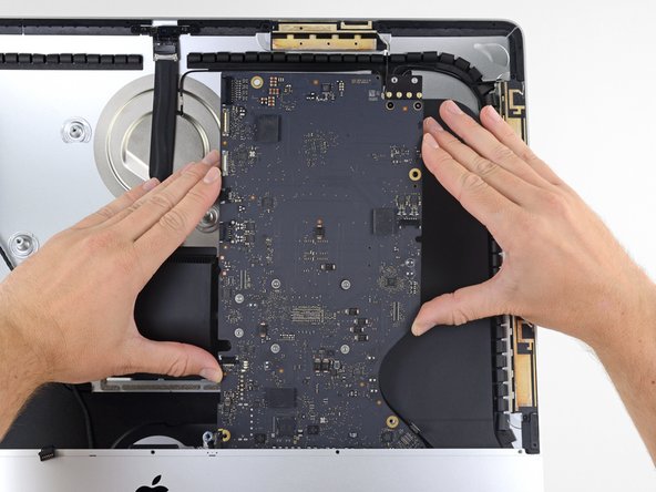

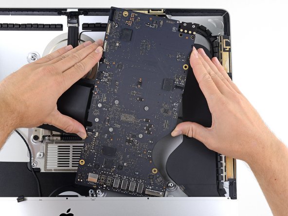

    • Use a spudger to disconnect the single SATA power and data combo cable by gently prying its large plastic connector away from the hard drive.

    • Flip up the metal retaining bracket on the FaceTime camera cable connector.
    • Pull the FaceTime camera cable straight out of its socket on the logic board.
    • This is a delicate connector that can be easily damaged.

    • Remove the four 7.3 mm T8 Torx screws securing the logic board to the rear enclosure.
  59. iMac Intel 21.5" EMC 3068 RAM Replacement: crwdns2935265:059crwdnd2935265:01crwdnd2935265:03crwdne2935265:0 iMac Intel 21.5" EMC 3068 RAM Replacement: crwdns2935265:059crwdnd2935265:02crwdnd2935265:03crwdne2935265:0 iMac Intel 21.5" EMC 3068 RAM Replacement: crwdns2935265:059crwdnd2935265:03crwdnd2935265:03crwdne2935265:0
    • Tilt the top of the logic board away from the rear enclosure.
    • When removing and installing the logic board, take care not to damage the delicate microphone ribbon cable at the bottom left.
    • Lift the logic board straight up and out of the iMac.
    • Be careful not to snag the board on any of the rear enclosure's screw posts.

    • When reassembling your iMac, be sure to align the exterior I/O ports correctly. The logic board can sit crooked even when secured with all its screws.
    • Use a USB flash drive and/or ethernet cable to ensure the logic board is aligned correctly while you screw it in.
  61. iMac Intel 21.5" EMC 3068 RAM Replacement, RAM: crwdns2935265:061crwdnd2935265:01crwdnd2935265:02crwdne2935265:0 iMac Intel 21.5" EMC 3068 RAM Replacement, RAM: crwdns2935265:061crwdnd2935265:02crwdnd2935265:02crwdne2935265:0
    • Handling the board by the edges, flip the logic board over to access the two RAM modules.
    • Two clips secure the RAM module in place, one on each side. Using your fingers, spread the clips away from the RAM module.
    • When released, the RAM module will pop up at a slight angle.
  62. iMac Intel 21.5" EMC 3068 RAM Replacement: crwdns2935265:062crwdnd2935265:01crwdnd2935265:02crwdne2935265:0 iMac Intel 21.5" EMC 3068 RAM Replacement: crwdns2935265:062crwdnd2935265:02crwdnd2935265:02crwdne2935265:0
    • Lift the RAM module to an angle of about 30 degrees and slide it out.
    • When handling the RAM module, touch only the outside edges. Take care not to touch the gold-colored contact points along the bottom edge.
    • To install a new RAM module, slide it in place at about the same angle until it is snug, and then swing it downward until the two clips snap into place.
  63. iMac Intel 21.5" EMC 3068 RAM Replacement: crwdns2935265:063crwdnd2935265:01crwdnd2935265:01crwdne2935265:0
    • The original RAM module closer to the logic board has a thermal pad adhered to its top side (facing away from the logic board, between the two DIMMs).
    • Peel off and transfer the thermal pad from the original RAM stick to your replacement RAM before you install it in the lower slot.
