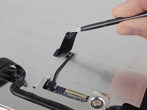

    4. iMac Intel 21.5" EMC 3068 Display Replacement: crwdns2935265:027crwdnd2935265:01crwdnd2935265:02crwdne2935265:0 iMac Intel 21.5" EMC 3068 Display Replacement: crwdns2935265:027crwdnd2935265:02crwdnd2935265:02crwdne2935265:0
      • Peel up the piece of tape securing the thermal sensor to the back of the display assembly.

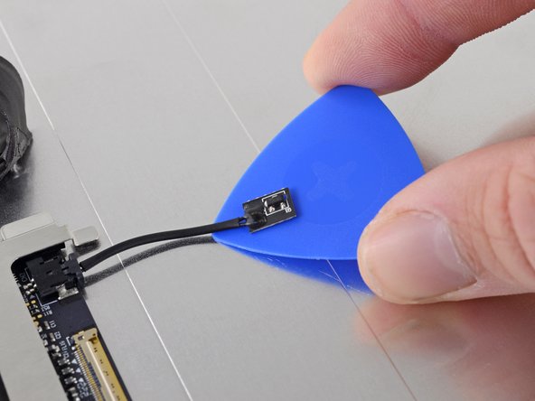

    5. iMac Intel 21.5" EMC 3068 Display Replacement: crwdns2935265:028crwdnd2935265:01crwdnd2935265:02crwdne2935265:0 iMac Intel 21.5" EMC 3068 Display Replacement: crwdns2935265:028crwdnd2935265:02crwdnd2935265:02crwdne2935265:0
      • Use an opening pick to break up the adhesive holding the thermal sensor to the back of the iMac display.
    6. iMac Intel 21.5" EMC 3068 Display Replacement: crwdns2935265:029crwdnd2935265:01crwdnd2935265:02crwdne2935265:0 iMac Intel 21.5" EMC 3068 Display Replacement: crwdns2935265:029crwdnd2935265:02crwdnd2935265:02crwdne2935265:0
      • Disconnect the thermal sensor from its socket on the back of the display.
      • Remove the thermal sensor and transfer it to your new display assembly.
