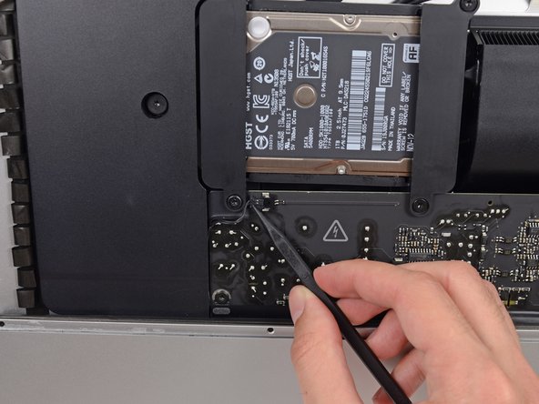

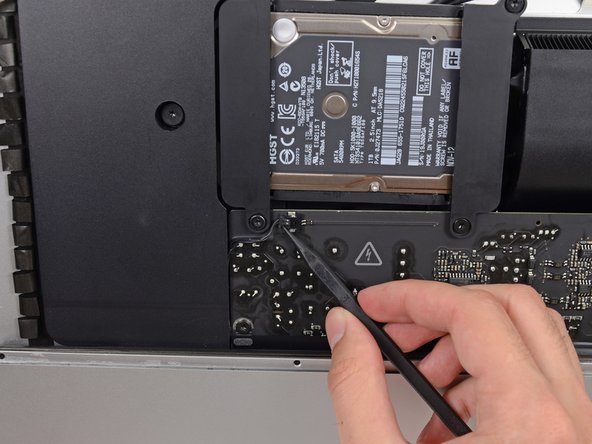

    • Use a spudger to disconnect the power button connector from its socket on the logic board.
    • Be careful not to touch any solder joints on the back of the power supply. Capacitors may be charged enough to give you a dangerous shock.

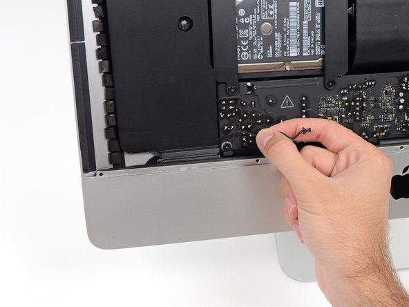

  32. iMac Intel 21.5" EMC 2889 Left Speaker Replacement: crwdns2935265:032crwdnd2935265:01crwdnd2935265:01crwdne2935265:0
    • Remove the two 10.0 mm T10 screws securing the left speaker to the rear case.
    • Rubber washers keep the screws snug in the speaker even when loosened. You can use tweezers or a fingernail to remove the screws, or simply leave them with the speaker assembly.

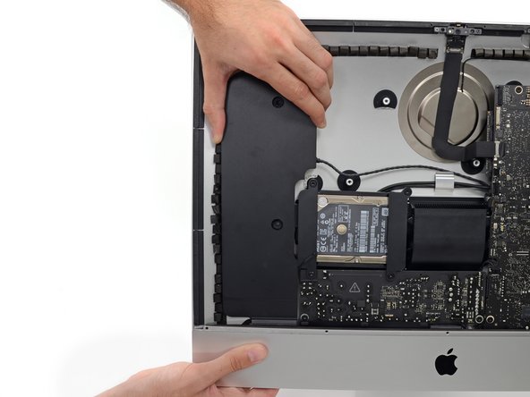

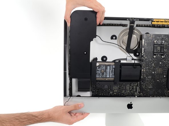

  33. iMac Intel 21.5" EMC 2889 Left Speaker Replacement: crwdns2935265:033crwdnd2935265:01crwdnd2935265:02crwdne2935265:0 iMac Intel 21.5" EMC 2889 Left Speaker Replacement: crwdns2935265:033crwdnd2935265:02crwdnd2935265:02crwdne2935265:0
    • Lift the left speaker straight up, until the power button cable is exposed (about 0.5").
  34. iMac Intel 21.5" EMC 2889 Left Speaker Replacement: crwdns2935265:034crwdnd2935265:01crwdnd2935265:03crwdne2935265:0 iMac Intel 21.5" EMC 2889 Left Speaker Replacement: crwdns2935265:034crwdnd2935265:02crwdnd2935265:03crwdne2935265:0 iMac Intel 21.5" EMC 2889 Left Speaker Replacement: crwdns2935265:034crwdnd2935265:03crwdnd2935265:03crwdne2935265:0

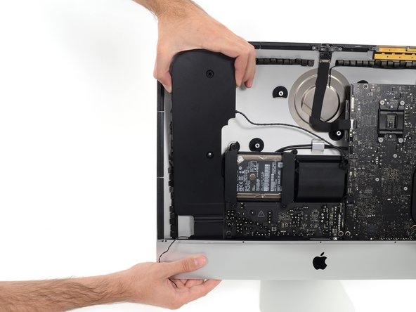

    • Gently de-route the power button cable from its groove in the left speaker.
  35. iMac Intel 21.5" EMC 2889 Left Speaker Replacement: crwdns2935265:035crwdnd2935265:01crwdnd2935265:03crwdne2935265:0 iMac Intel 21.5" EMC 2889 Left Speaker Replacement: crwdns2935265:035crwdnd2935265:02crwdnd2935265:03crwdne2935265:0 iMac Intel 21.5" EMC 2889 Left Speaker Replacement: crwdns2935265:035crwdnd2935265:03crwdnd2935265:03crwdne2935265:0
    • Lift the left speaker straight up and remove it from the iMac.
