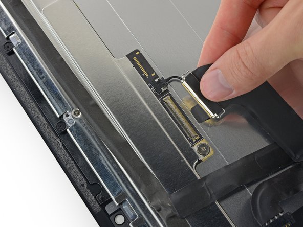

Use your fingernail or the pointed tip of a spudger to flip up the retaining flap on the display data connector.
Pull the display data cable connector straight out of its socket on the back of the display.

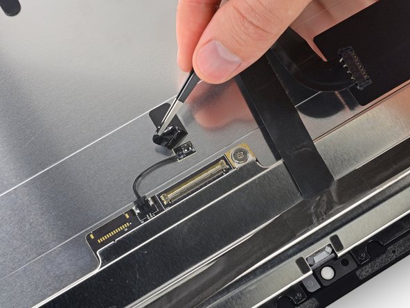

Use an iOpener near the top edge of the display assembly to heat and soften the adhesive on the piece of tape holding the thermal sensor in place.
Peel up the piece of tape securing the thermal sensor to the back of the display assembly.
Use an opening pick to break up the adhesive holding the thermal sensor to the back of the iMac display.
Disconnect the thermal sensor from its socket on the back of the display.
Remove the thermal sensor and transfer it to your new display assembly.

Does not say how to transfer the thermal sensor to the new display
Is there any way to disconnect the display From the logic board, but then reconnect the sensor? I have a 2015 iMac that has a smashed up screen glass which I am trying to use like a Mac mini. But leaving the built in display connected causes some problems, and I can't seem to find a way to force the iMac to disable the internal display.
