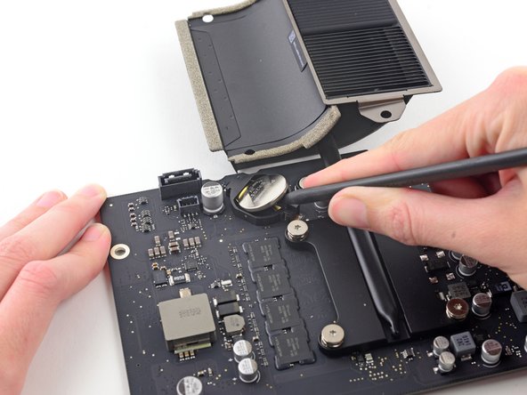

iMac Intel 21.5" EMC 2805 PRAM Battery Replacement
    1. iMac Intel 21.5" EMC 2805 PRAM Battery Replacement, Display Assembly: crwdns2935265:01crwdnd2935265:01crwdnd2935265:01crwdne2935265:0

      • Flip the power supply over to access the DC power cable connection behind the logic board.
      • Squeeze the tab on the back side of the DC power cable connector and pull it straight out of its socket on the back of the logic board.
    9. iMac Intel 21.5" EMC 2805 PRAM Battery Replacement: crwdns2935265:040crwdnd2935265:01crwdnd2935265:03crwdne2935265:0 iMac Intel 21.5" EMC 2805 PRAM Battery Replacement: crwdns2935265:040crwdnd2935265:02crwdnd2935265:03crwdne2935265:0 iMac Intel 21.5" EMC 2805 PRAM Battery Replacement: crwdns2935265:040crwdnd2935265:03crwdnd2935265:03crwdne2935265:0
      • You may find it helpful to set the iMac down on its back for the next couple of steps.
      • Use the flat end of a spudger to press the clip on the side of the AC inlet cable connector inward.

    1. iMac Intel 21.5" EMC 2805 PRAM Battery Replacement, PRAM Battery: crwdns2935265:065crwdnd2935265:01crwdnd2935265:02crwdne2935265:0 iMac Intel 21.5" EMC 2805 PRAM Battery Replacement, PRAM Battery: crwdns2935265:065crwdnd2935265:02crwdnd2935265:02crwdne2935265:0
      • Carefully wedge the tip of a spudger underneath the opening in the PRAM battery enclosure.
      • Pry the PRAM battery out of the enclosure.
    2. iMac Intel 21.5" EMC 2805 PRAM Battery Replacement: crwdns2935265:066crwdnd2935265:01crwdnd2935265:01crwdne2935265:0
      • Lift and remove the PRAM battery off the logic board.
To reassemble your device, follow these instructions in reverse and use our Adhesive Strips Guide to reattach the display glass.
