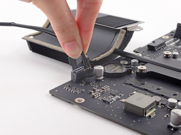

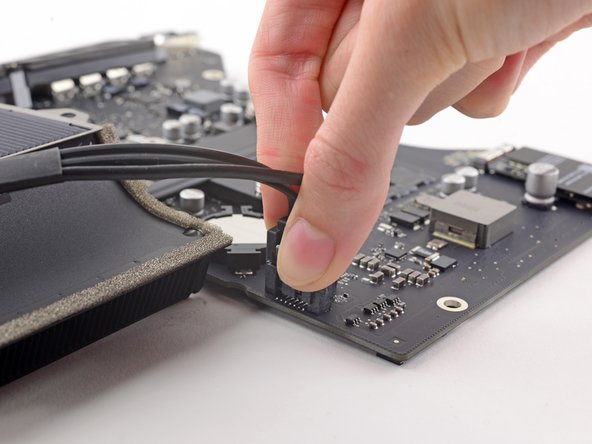

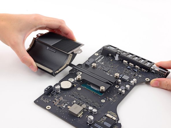

  40. iMac Intel 21.5" EMC 2805 Logic Board Replacement: crwdns2935265:040crwdnd2935265:01crwdnd2935265:03crwdne2935265:0 iMac Intel 21.5" EMC 2805 Logic Board Replacement: crwdns2935265:040crwdnd2935265:02crwdnd2935265:03crwdne2935265:0 iMac Intel 21.5" EMC 2805 Logic Board Replacement: crwdns2935265:040crwdnd2935265:03crwdnd2935265:03crwdne2935265:0
    • You may find it helpful to set the iMac down on its back for the next couple of steps.
    • Use the flat end of a spudger to press the clip on the side of the AC inlet cable connector inward.

  63. iMac Intel 21.5" EMC 2805 Logic Board Replacement, SATA Data and Power Cables: crwdns2935265:063crwdnd2935265:01crwdnd2935265:03crwdne2935265:0 iMac Intel 21.5" EMC 2805 Logic Board Replacement, SATA Data and Power Cables: crwdns2935265:063crwdnd2935265:02crwdnd2935265:03crwdne2935265:0 iMac Intel 21.5" EMC 2805 Logic Board Replacement, SATA Data and Power Cables: crwdns2935265:063crwdnd2935265:03crwdnd2935265:03crwdne2935265:0
    • The SATA data connector has a clip that must be pressed to allow removal.
    • While pressing on the clip with your thumb, lift and disconnect the SATA data connector from its socket on the logic board.
  64. iMac Intel 21.5" EMC 2805 Logic Board Replacement: crwdns2935265:064crwdnd2935265:01crwdnd2935265:02crwdne2935265:0 iMac Intel 21.5" EMC 2805 Logic Board Replacement: crwdns2935265:064crwdnd2935265:02crwdnd2935265:02crwdne2935265:0
    • Grasp the hard drive power connector and gently pull it out of its socket on the logic board.
  65. iMac Intel 21.5" EMC 2805 Logic Board Replacement, Heat Sink: crwdns2935265:065crwdnd2935265:01crwdnd2935265:01crwdne2935265:0
    • The following screws secure the heat sink to the logic board:
    • Remove the two T8 screws from the exhaust port end of the heat sink.
    • Loosen, but do not remove, the four captive T8 screws securing the CPU end of the heat sink.
  66. iMac Intel 21.5" EMC 2805 Logic Board Replacement: crwdns2935265:066crwdnd2935265:01crwdnd2935265:02crwdne2935265:0 iMac Intel 21.5" EMC 2805 Logic Board Replacement: crwdns2935265:066crwdnd2935265:02crwdnd2935265:02crwdne2935265:0
    • Slowly lift and remove the heat sink from the logic board.
    • When reassembling your iMac, follow our thermal paste application guide to reapply the thermal paste.
