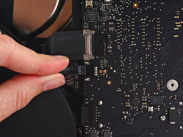

  19. iMac Intel 21.5" EMC 2805 Fan Replacement, Display Assembly Cables: crwdns2935265:019crwdnd2935265:01crwdnd2935265:03crwdne2935265:0 iMac Intel 21.5" EMC 2805 Fan Replacement, Display Assembly Cables: crwdns2935265:019crwdnd2935265:02crwdnd2935265:03crwdne2935265:0 iMac Intel 21.5" EMC 2805 Fan Replacement, Display Assembly Cables: crwdns2935265:019crwdnd2935265:03crwdnd2935265:03crwdne2935265:0
    • Use a pair of tweezers to flip up the metal retaining bracket on the display data cable.
    • Carefully pull the display data cable from its socket on the logic board.
    • Be sure to pull the display data cable connector straight out of its socket.
  20. iMac Intel 21.5" EMC 2805 Fan Replacement: crwdns2935265:020crwdnd2935265:01crwdnd2935265:02crwdne2935265:0 iMac Intel 21.5" EMC 2805 Fan Replacement: crwdns2935265:020crwdnd2935265:02crwdnd2935265:02crwdne2935265:0
    • While holding the display up with one hand, use the other hand to unplug the display power cable.
    • Lift the display up enough to have easy access to the connector, but not so much that you stretch the cables and stress their connections (about 8").

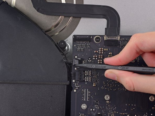

  24. iMac Intel 21.5" EMC 2805 Fan Replacement, Fan: crwdns2935265:024crwdnd2935265:01crwdnd2935265:02crwdne2935265:0 iMac Intel 21.5" EMC 2805 Fan Replacement, Fan: crwdns2935265:024crwdnd2935265:02crwdnd2935265:02crwdne2935265:0
    • It is recommended to stand the iMac vertically on its stand.
    • Use the tip of a spudger to push the fan cable connector out of its socket on the logic board.
    • It is recommended to carefully push on both sides of the connector to walk it out of its socket.

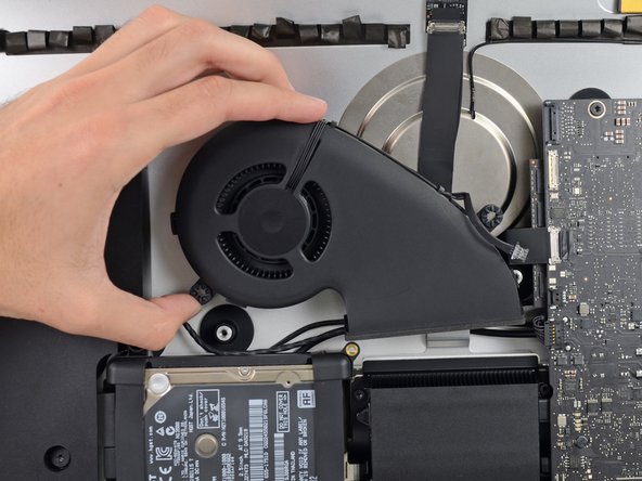

    • Remove the following screws securing the fan to the rear enclosure:
    • Two 12.5 mm T10 screws
    • One 9.9 mm T10 screw

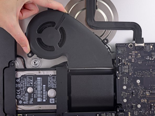

  26. iMac Intel 21.5" EMC 2805 Fan Replacement: crwdns2935265:026crwdnd2935265:01crwdnd2935265:02crwdne2935265:0 iMac Intel 21.5" EMC 2805 Fan Replacement: crwdns2935265:026crwdnd2935265:02crwdnd2935265:02crwdne2935265:0
    • Gently lift the fan up and remove it from the iMac.
To reassemble your device, follow these instructions in reverse and use our Adhesive Strips Guide to reattach the display glass.
