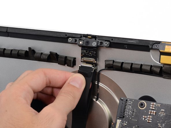

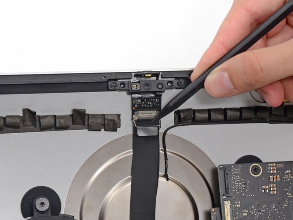

  24. iMac Intel 21.5" EMC 2638 iSight Camera Replacement, iSight Camera and Microphone Cable: crwdns2935265:024crwdnd2935265:01crwdnd2935265:02crwdne2935265:0 iMac Intel 21.5" EMC 2638 iSight Camera Replacement, iSight Camera and Microphone Cable: crwdns2935265:024crwdnd2935265:02crwdnd2935265:02crwdne2935265:0
    • Use the tip of a spudger to flip down the metal retaining bracket on the iSight camera cable.
  25. iMac Intel 21.5" EMC 2638 iSight Camera Replacement: crwdns2935265:025crwdnd2935265:01crwdnd2935265:02crwdne2935265:0 iMac Intel 21.5" EMC 2638 iSight Camera Replacement: crwdns2935265:025crwdnd2935265:02crwdnd2935265:02crwdne2935265:0
    • Gently pull the iSight camera cable straight down from its socket on the camera board.
    • Be sure to remove only the iSight connector—the microphone connector is on a separate branch of the cable.
  26. iMac Intel 21.5" EMC 2638 iSight Camera Replacement: crwdns2935265:026crwdnd2935265:01crwdnd2935265:01crwdne2935265:0
    • Disconnect the microphone cable from its socket on the camera board by carefully pulling straight down.

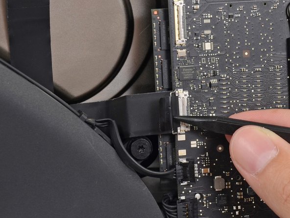

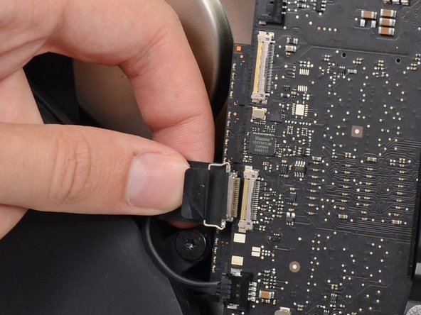

    • Use the tip of a spudger to flip up the metal retaining bracket on the iSight camera cable located on the logic board.
  28. iMac Intel 21.5" EMC 2638 iSight Camera Replacement: crwdns2935265:028crwdnd2935265:01crwdnd2935265:02crwdne2935265:0 iMac Intel 21.5" EMC 2638 iSight Camera Replacement: crwdns2935265:028crwdnd2935265:02crwdnd2935265:02crwdne2935265:0
    • Pull the iSight camera cable straight away from its connector on the logic board.
    • Do not use excessive force. This is a delicate connector that can easily be damaged.

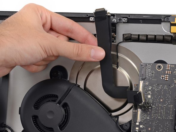

  29. iMac Intel 21.5" EMC 2638 iSight Camera Replacement: crwdns2935265:029crwdnd2935265:01crwdnd2935265:02crwdne2935265:0 iMac Intel 21.5" EMC 2638 iSight Camera Replacement: crwdns2935265:029crwdnd2935265:02crwdnd2935265:02crwdne2935265:0
    • Peel and remove the iSight camera cable from the rear enclosure.
    • If you have trouble peeling the cable from the adhesive securing it to the rear enclosure, use a spudger to help pry it free.
