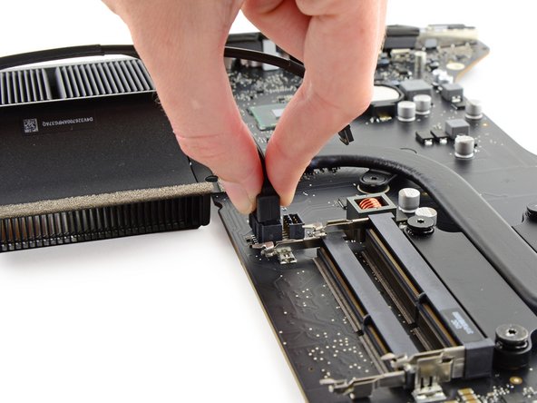

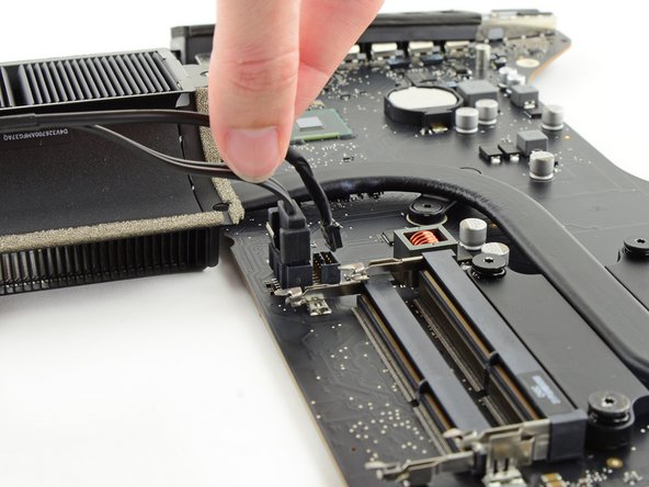

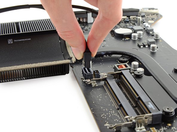

    • Be very careful not to touch the capacitor leads or any exposed solder joints on the back of the power supply. Only handle the board by the edges.
    • Flip the power supply over to access the DC power cable connection behind the logic board.
    • Squeeze the tab on the back side of the DC power cable connector and pull it straight out of its socket on the back of the logic board.
  40. iMac Intel 21.5" EMC 2638 Logic Board Replacement: crwdns2935265:040crwdnd2935265:01crwdnd2935265:03crwdne2935265:0 iMac Intel 21.5" EMC 2638 Logic Board Replacement: crwdns2935265:040crwdnd2935265:02crwdnd2935265:03crwdne2935265:0 iMac Intel 21.5" EMC 2638 Logic Board Replacement: crwdns2935265:040crwdnd2935265:03crwdnd2935265:03crwdne2935265:0
    • You may find it helpful to set the iMac down on its back for the next couple of steps.
    • Use the flat end of a spudger to press the clip on the side of the AC inlet cable connector inward.

  63. iMac Intel 21.5" EMC 2638 Logic Board Replacement, Logic Board: crwdns2935265:063crwdnd2935265:01crwdnd2935265:02crwdne2935265:0 iMac Intel 21.5" EMC 2638 Logic Board Replacement, Logic Board: crwdns2935265:063crwdnd2935265:02crwdnd2935265:02crwdne2935265:0
    • Grasp the hard drive power connector and gently pull it out of its socket on the logic board.
  64. iMac Intel 21.5" EMC 2638 Logic Board Replacement: crwdns2935265:064crwdnd2935265:01crwdnd2935265:03crwdne2935265:0 iMac Intel 21.5" EMC 2638 Logic Board Replacement: crwdns2935265:064crwdnd2935265:02crwdnd2935265:03crwdne2935265:0 iMac Intel 21.5" EMC 2638 Logic Board Replacement: crwdns2935265:064crwdnd2935265:03crwdnd2935265:03crwdne2935265:0
    • The SATA data connector has a clip that must be pressed to allow removal.
    • While pressing on the clip with your thumb, lift and disconnect the SATA data connector from its socket on the logic board.
