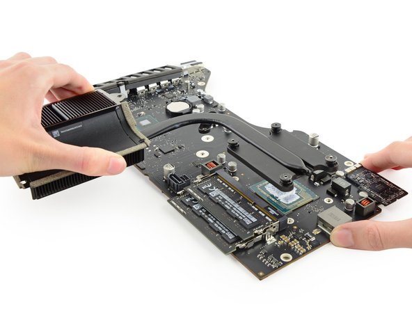

    • Rock the power supply forward and remove it from its recess in the rear enclosure.
    • Do not try to completely remove the power supply from the iMac yet—it is still connected to the logic board.

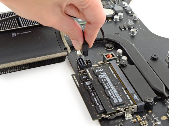

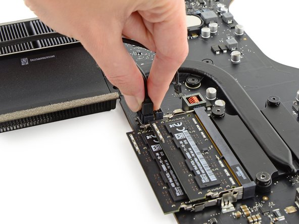

    • Be very careful not to touch the capacitor leads or any exposed solder joints on the back of the power supply. Only handle the board by the edges.
    • Flip the power supply over to access the DC power cable connection behind the logic board.
    • Squeeze the tab on the back side of the DC power cable connector and pull it straight out of its socket on the back of the logic board.

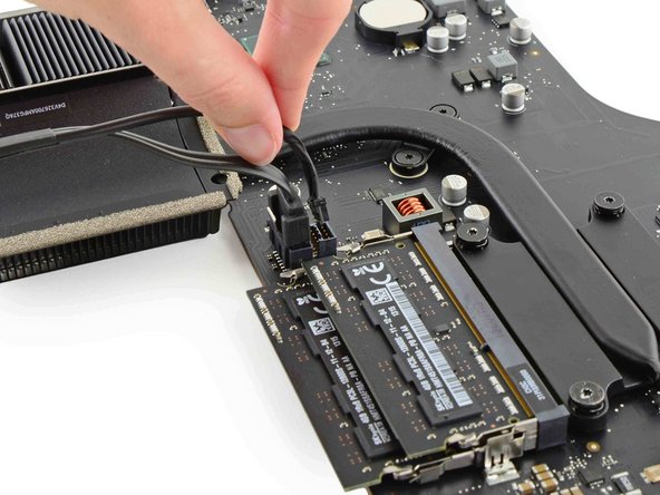

  40. iMac Intel 21.5" EMC 2638 Heat Sink Replacement: crwdns2935265:040crwdnd2935265:01crwdnd2935265:03crwdne2935265:0 iMac Intel 21.5" EMC 2638 Heat Sink Replacement: crwdns2935265:040crwdnd2935265:02crwdnd2935265:03crwdne2935265:0 iMac Intel 21.5" EMC 2638 Heat Sink Replacement: crwdns2935265:040crwdnd2935265:03crwdnd2935265:03crwdne2935265:0
    • You may find it helpful to set the iMac down on its back for the next couple of steps.
    • Use the flat end of a spudger to press the clip on the side of the AC inlet cable connector inward.

  60. iMac Intel 21.5" EMC 2638 Heat Sink Replacement, SATA Data and Power Cables: crwdns2935265:060crwdnd2935265:01crwdnd2935265:02crwdne2935265:0 iMac Intel 21.5" EMC 2638 Heat Sink Replacement, SATA Data and Power Cables: crwdns2935265:060crwdnd2935265:02crwdnd2935265:02crwdne2935265:0
    • Grasp the hard drive power connector and gently pull it out of its socket on the logic board.
  61. iMac Intel 21.5" EMC 2638 Heat Sink Replacement: crwdns2935265:061crwdnd2935265:01crwdnd2935265:03crwdne2935265:0 iMac Intel 21.5" EMC 2638 Heat Sink Replacement: crwdns2935265:061crwdnd2935265:02crwdnd2935265:03crwdne2935265:0 iMac Intel 21.5" EMC 2638 Heat Sink Replacement: crwdns2935265:061crwdnd2935265:03crwdnd2935265:03crwdne2935265:0
    • The SATA data connector has a clip that must be pressed to allow removal.
    • While pressing on the clip with your thumb, lift and disconnect the SATA data connector from its socket on the logic board.
  62. iMac Intel 21.5" EMC 2638 Heat Sink Replacement, Heat Sink: crwdns2935265:062crwdnd2935265:01crwdnd2935265:01crwdne2935265:0
    • The following screws secure the heat sink to the logic board:
    • Remove the two T8 screws from the exhaust port end of the heat sink.
    • Loosen, but do not remove, the four captive T8 screws securing the CPU end of the heat sink.
  63. iMac Intel 21.5" EMC 2638 Heat Sink Replacement: crwdns2935265:063crwdnd2935265:01crwdnd2935265:02crwdne2935265:0 iMac Intel 21.5" EMC 2638 Heat Sink Replacement: crwdns2935265:063crwdnd2935265:02crwdnd2935265:02crwdne2935265:0
    • Slowly lift and remove the heat sink from the logic board.
    • When reassembling your iMac, follow our thermal paste application guide to reapply the thermal paste.
