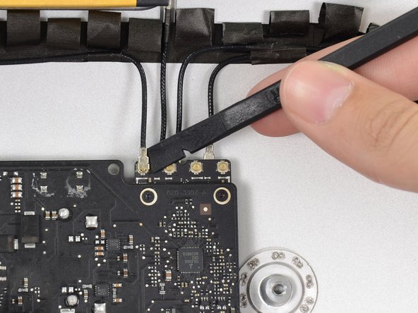

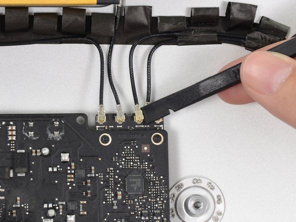

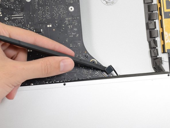

  26. iMac Intel 21.5" EMC 2638 Blade SSD Replacement, Right Speaker: crwdns2935265:026crwdnd2935265:01crwdnd2935265:02crwdne2935265:0 iMac Intel 21.5" EMC 2638 Blade SSD Replacement, Right Speaker: crwdns2935265:026crwdnd2935265:02crwdnd2935265:02crwdne2935265:0
    • Use a spudger to loosen the right speaker cable's connector from its socket on the logic board.
    • It is useful to push downward on both short sides of the connector to walk it out of its socket. Be careful with the corners of the connectors, as they can be easily broken off.
    • Pull the connector downwards to remove it from its socket.

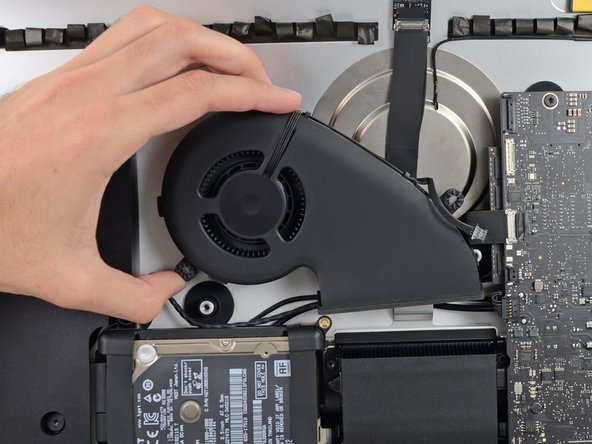

    • Gently pull the fan cable connector straight away from its socket on the logic board.
  43. iMac Intel 21.5" EMC 2638 Blade SSD Replacement: crwdns2935265:043crwdnd2935265:01crwdnd2935265:01crwdne2935265:0
    • Remove the three 12.3 mm T10 shoulder screws securing the fan to the rear enclosure.
  44. iMac Intel 21.5" EMC 2638 Blade SSD Replacement: crwdns2935265:044crwdnd2935265:01crwdnd2935265:02crwdne2935265:0 iMac Intel 21.5" EMC 2638 Blade SSD Replacement: crwdns2935265:044crwdnd2935265:02crwdnd2935265:02crwdne2935265:0
    • Remove the fan from the iMac.

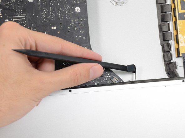

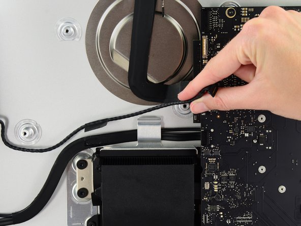

    • Push on each side of the left speaker cable connector with the tip of a spudger and gently walk it out of its socket.

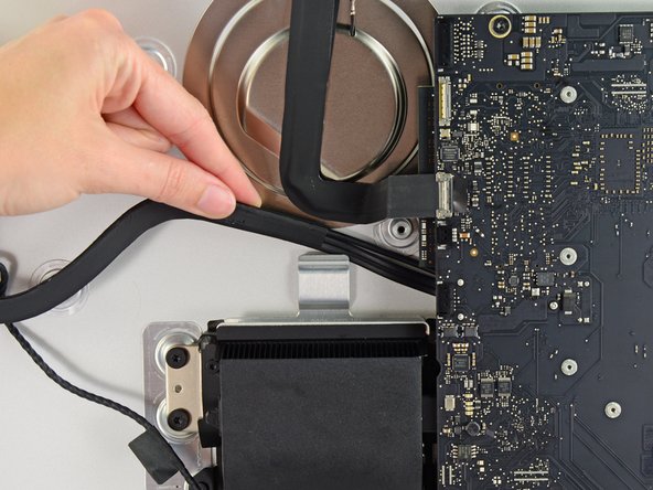

    • De-route the left speaker cable by pulling it straight up out of the retaining clip in the back of the rear enclosure.
    • In a similar fashion, lift the combo SATA data/power cable up out of the retaining clip.

  54. iMac Intel 21.5" EMC 2638 Blade SSD Replacement: crwdns2935265:054crwdnd2935265:01crwdnd2935265:03crwdne2935265:0 iMac Intel 21.5" EMC 2638 Blade SSD Replacement: crwdns2935265:054crwdnd2935265:02crwdnd2935265:03crwdne2935265:0 iMac Intel 21.5" EMC 2638 Blade SSD Replacement: crwdns2935265:054crwdnd2935265:03crwdnd2935265:03crwdne2935265:0
    • Use the flat edge of a spudger to disconnect each of the four antenna connectors from the AirPort/Bluetooth card.
    • Note the original positions for each connector when reconnecting the cables.
  55. iMac Intel 21.5" EMC 2638 Blade SSD Replacement: crwdns2935265:055crwdnd2935265:01crwdnd2935265:03crwdne2935265:0 iMac Intel 21.5" EMC 2638 Blade SSD Replacement: crwdns2935265:055crwdnd2935265:02crwdnd2935265:03crwdne2935265:0 iMac Intel 21.5" EMC 2638 Blade SSD Replacement: crwdns2935265:055crwdnd2935265:03crwdnd2935265:03crwdne2935265:0
    • Use the flat edge of a spudger to pry the headphone jack cable connector from its socket on the logic board.
    • Push the cable slightly to the right to clear it for the removal of the logic board.

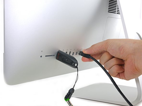

    • When installing the logic board, take care to align the exterior I/O ports correctly. The logic board can sit crooked even when secured with all its screws.
    • Use a USB flash drive and/or ethernet cable to ensure the logic board is seated correctly while you screw it in.
