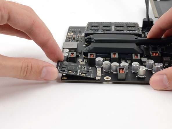

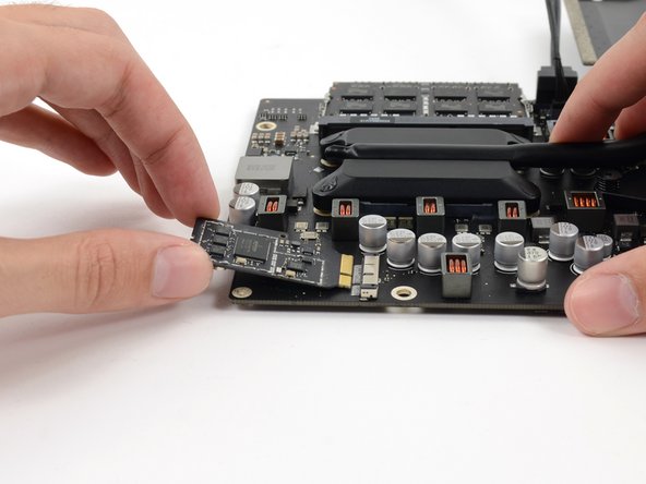

  32. iMac Intel 21.5" EMC 2638 AirPort/Bluetooth Card Replacement, Power Supply: crwdns2935265:032crwdnd2935265:01crwdnd2935265:03crwdne2935265:0 iMac Intel 21.5" EMC 2638 AirPort/Bluetooth Card Replacement, Power Supply: crwdns2935265:032crwdnd2935265:02crwdnd2935265:03crwdne2935265:0 iMac Intel 21.5" EMC 2638 AirPort/Bluetooth Card Replacement, Power Supply: crwdns2935265:032crwdnd2935265:03crwdnd2935265:03crwdne2935265:0
    • The next few steps bring your hands close to the exposed face of the power supply. Do not touch the face of the power supply or any of the exposed solder. Touching it risks a high voltage shock from the many large capacitors attached to the board.
    • Use the tip of a spudger to push each side of the power button cable connector and gently walk it out of its socket.
  33. iMac Intel 21.5" EMC 2638 AirPort/Bluetooth Card Replacement: crwdns2935265:033crwdnd2935265:01crwdnd2935265:02crwdne2935265:0 iMac Intel 21.5" EMC 2638 AirPort/Bluetooth Card Replacement: crwdns2935265:033crwdnd2935265:02crwdnd2935265:02crwdne2935265:0
    • Use the tip of a spudger to push each side of the power supply control cable connector and gently walk it out of its socket.
  34. iMac Intel 21.5" EMC 2638 AirPort/Bluetooth Card Replacement: crwdns2935265:034crwdnd2935265:01crwdnd2935265:01crwdne2935265:0
    • Remove the two 7.2 mm T10 Torx screws securing the power supply to the rear enclosure.
    • In newer model iMacs these are 7.2 mm T8 Torx screws.
    • During reassembly, be careful not to trap the power button wire behind the board.
  35. iMac Intel 21.5" EMC 2638 AirPort/Bluetooth Card Replacement: crwdns2935265:035crwdnd2935265:01crwdnd2935265:02crwdne2935265:0 iMac Intel 21.5" EMC 2638 AirPort/Bluetooth Card Replacement: crwdns2935265:035crwdnd2935265:02crwdnd2935265:02crwdne2935265:0
    • When working on the power supply, be very careful not to touch the capacitor leads or any exposed solder joints on the back of the power supply. Only handle the board by the edges.
    • Tilt the power supply forward.
  36. iMac Intel 21.5" EMC 2638 AirPort/Bluetooth Card Replacement: crwdns2935265:036crwdnd2935265:01crwdnd2935265:03crwdne2935265:0 iMac Intel 21.5" EMC 2638 AirPort/Bluetooth Card Replacement: crwdns2935265:036crwdnd2935265:02crwdnd2935265:03crwdne2935265:0 iMac Intel 21.5" EMC 2638 AirPort/Bluetooth Card Replacement: crwdns2935265:036crwdnd2935265:03crwdnd2935265:03crwdne2935265:0
    • Pull the power supply slightly up and out from the rear enclosure.
    • Rotate the power supply counterclockwise, lifting the right side up about an inch higher than the left.
  37. iMac Intel 21.5" EMC 2638 AirPort/Bluetooth Card Replacement: crwdns2935265:037crwdnd2935265:01crwdnd2935265:02crwdne2935265:0 iMac Intel 21.5" EMC 2638 AirPort/Bluetooth Card Replacement: crwdns2935265:037crwdnd2935265:02crwdnd2935265:02crwdne2935265:0
    • Slide the power supply to the right to clear the screw posts on the rear enclosure.
  38. iMac Intel 21.5" EMC 2638 AirPort/Bluetooth Card Replacement: crwdns2935265:038crwdnd2935265:01crwdnd2935265:03crwdne2935265:0 iMac Intel 21.5" EMC 2638 AirPort/Bluetooth Card Replacement: crwdns2935265:038crwdnd2935265:02crwdnd2935265:03crwdne2935265:0 iMac Intel 21.5" EMC 2638 AirPort/Bluetooth Card Replacement: crwdns2935265:038crwdnd2935265:03crwdnd2935265:03crwdne2935265:0
    • Rock the power supply forward and remove it from its recess in the rear enclosure.
    • Do not try to completely remove the power supply from the iMac yet—it is still connected to the logic board.
  39. iMac Intel 21.5" EMC 2638 AirPort/Bluetooth Card Replacement: crwdns2935265:039crwdnd2935265:01crwdnd2935265:02crwdne2935265:0 iMac Intel 21.5" EMC 2638 AirPort/Bluetooth Card Replacement: crwdns2935265:039crwdnd2935265:02crwdnd2935265:02crwdne2935265:0
    • Be very careful not to touch the capacitor leads or any exposed solder joints on the back of the power supply. Only handle the board by the edges.
    • Flip the power supply over to access the DC power cable connection behind the logic board.
    • Squeeze the tab on the back side of the DC power cable connector and pull it straight out of its socket on the back of the logic board.
  40. iMac Intel 21.5" EMC 2638 AirPort/Bluetooth Card Replacement: crwdns2935265:040crwdnd2935265:01crwdnd2935265:03crwdne2935265:0 iMac Intel 21.5" EMC 2638 AirPort/Bluetooth Card Replacement: crwdns2935265:040crwdnd2935265:02crwdnd2935265:03crwdne2935265:0 iMac Intel 21.5" EMC 2638 AirPort/Bluetooth Card Replacement: crwdns2935265:040crwdnd2935265:03crwdnd2935265:03crwdne2935265:0
    • You may find it helpful to set the iMac down on its back for the next couple of steps.
    • Use the flat end of a spudger to press the clip on the side of the AC inlet cable connector inward.

  60. iMac Intel 21.5" EMC 2638 AirPort/Bluetooth Card Replacement, AirPort/Bluetooth Card: crwdns2935265:060crwdnd2935265:01crwdnd2935265:01crwdne2935265:0
    • Remove the two 3.2 mm T5 screws securing the AirPort/Bluetooth card to the logic board.
  61. iMac Intel 21.5" EMC 2638 AirPort/Bluetooth Card Replacement: crwdns2935265:061crwdnd2935265:01crwdnd2935265:03crwdne2935265:0 iMac Intel 21.5" EMC 2638 AirPort/Bluetooth Card Replacement: crwdns2935265:061crwdnd2935265:02crwdnd2935265:03crwdne2935265:0 iMac Intel 21.5" EMC 2638 AirPort/Bluetooth Card Replacement: crwdns2935265:061crwdnd2935265:03crwdnd2935265:03crwdne2935265:0
    • Slightly lift the AirPort/Bluetooth card and pull it straight out its socket.
    • Do not use excessive force to pull the end of the AirPort/Bluetooth Card away from its socket on the logic board. Doing so may damage the socket.
    • When reinstalling the card, be sure it is properly seated before reinstalling the retaining screws.
