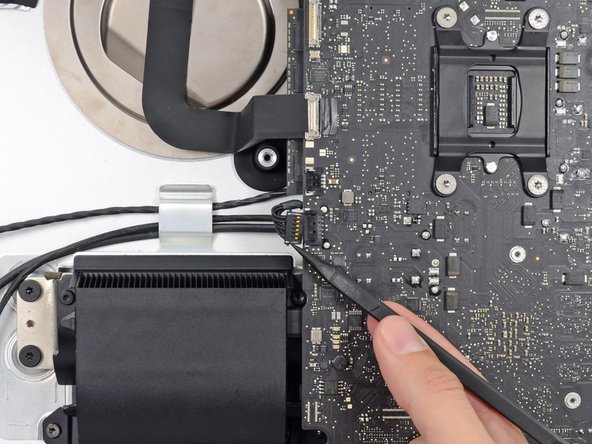

  19. iMac Intel 21.5" EMC 2544 Logic Board Replacement: crwdns2935265:019crwdnd2935265:01crwdnd2935265:02crwdne2935265:0 iMac Intel 21.5" EMC 2544 Logic Board Replacement: crwdns2935265:019crwdnd2935265:02crwdnd2935265:02crwdne2935265:0
    • While holding the display up with one hand, use the other hand to unplug the display power cable. Make sure that you pull the cable out from the plastic tab, and not by pulling on the color wires.
    • Lift the display up enough to have easy access to the connector, but not so much that you stretch the cables and stress their connections (about 8").

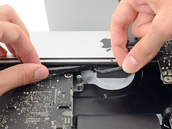

  20. iMac Intel 21.5" EMC 2544 Logic Board Replacement: crwdns2935265:020crwdnd2935265:01crwdnd2935265:03crwdne2935265:0 iMac Intel 21.5" EMC 2544 Logic Board Replacement: crwdns2935265:020crwdnd2935265:02crwdnd2935265:03crwdne2935265:0 iMac Intel 21.5" EMC 2544 Logic Board Replacement: crwdns2935265:020crwdnd2935265:03crwdnd2935265:03crwdne2935265:0
    • Use the tip of a spudger to flip up the metal retaining bracket on the display data cable.
    • Carefully pull the display data cable from its socket on the logic board.
    • Be sure to pull the display data cable connector straight out of its socket.

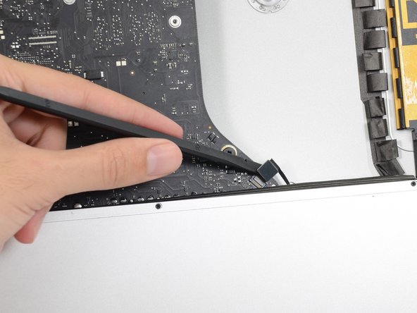

  26. iMac Intel 21.5" EMC 2544 Logic Board Replacement, Right Speaker: crwdns2935265:026crwdnd2935265:01crwdnd2935265:02crwdne2935265:0 iMac Intel 21.5" EMC 2544 Logic Board Replacement, Right Speaker: crwdns2935265:026crwdnd2935265:02crwdnd2935265:02crwdne2935265:0
    • Use a spudger to loosen the right speaker cable's connector from its socket on the logic board.
    • It is useful to push downward on both short sides of the connector to "walk" it out of its socket. Be careful with the corners of the connectors, they can be easily broken off.
    • Pull the connector downwards to remove it from its socket.

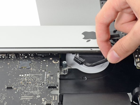

  27. iMac Intel 21.5" EMC 2544 Logic Board Replacement: crwdns2935265:027crwdnd2935265:01crwdnd2935265:01crwdne2935265:0
    • Remove the two 10.0 mm T10 screws securing the right speaker to the rear enclosure.
  28. iMac Intel 21.5" EMC 2544 Logic Board Replacement: crwdns2935265:028crwdnd2935265:01crwdnd2935265:02crwdne2935265:0 iMac Intel 21.5" EMC 2544 Logic Board Replacement: crwdns2935265:028crwdnd2935265:02crwdnd2935265:02crwdne2935265:0

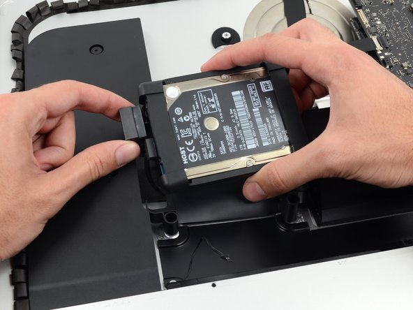

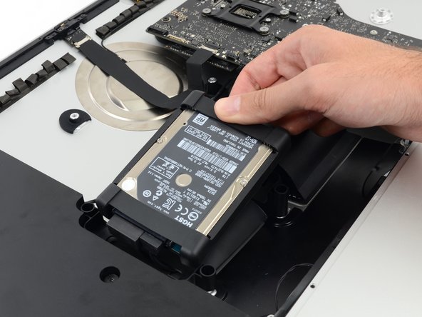

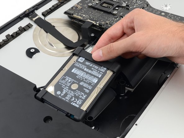

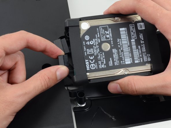

  31. iMac Intel 21.5" EMC 2544 Logic Board Replacement, Hard Drive Brackets: crwdns2935265:031crwdnd2935265:01crwdnd2935265:01crwdne2935265:0
    • Remove the following screws securing the hard drive bracket to the rear enclosure:
    • Two 21 mm T10 Torx screws from the left-hand hard drive bracket.
    • One 9 mm T10 Torx screw.
    • One 27 mm T10 Torx screw.
  32. iMac Intel 21.5" EMC 2544 Logic Board Replacement: crwdns2935265:032crwdnd2935265:01crwdnd2935265:02crwdne2935265:0 iMac Intel 21.5" EMC 2544 Logic Board Replacement: crwdns2935265:032crwdnd2935265:02crwdnd2935265:02crwdne2935265:0
    • Remove the left and right hard drive brackets from the iMac.

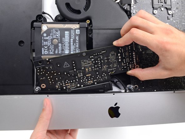

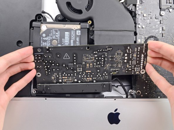

  33. iMac Intel 21.5" EMC 2544 Logic Board Replacement, Power Supply: crwdns2935265:033crwdnd2935265:01crwdnd2935265:03crwdne2935265:0 iMac Intel 21.5" EMC 2544 Logic Board Replacement, Power Supply: crwdns2935265:033crwdnd2935265:02crwdnd2935265:03crwdne2935265:0 iMac Intel 21.5" EMC 2544 Logic Board Replacement, Power Supply: crwdns2935265:033crwdnd2935265:03crwdnd2935265:03crwdne2935265:0
    • The next few steps bring your hands close to the exposed face of the power supply. Do not touch the face of the power supply to avoid a high voltage shock from the many large capacitors attached to the board.

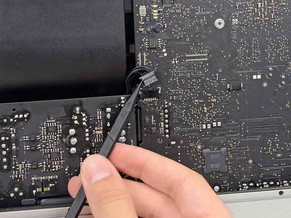

    • Use the tip of a spudger to push each side of the power button cable connector and gently "walk" it out of its socket.
  34. iMac Intel 21.5" EMC 2544 Logic Board Replacement: crwdns2935265:034crwdnd2935265:01crwdnd2935265:02crwdne2935265:0 iMac Intel 21.5" EMC 2544 Logic Board Replacement: crwdns2935265:034crwdnd2935265:02crwdnd2935265:02crwdne2935265:0
    • Gently push upward on each side of the power supply control cable connector with the tip of a spudger to gently "walk" it out of its socket.

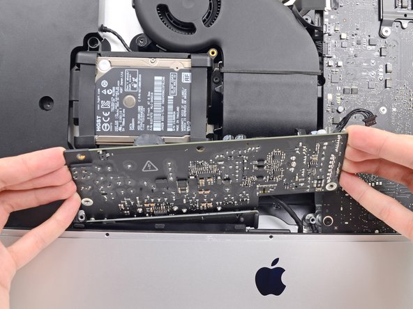

  35. iMac Intel 21.5" EMC 2544 Logic Board Replacement: crwdns2935265:035crwdnd2935265:01crwdnd2935265:01crwdne2935265:0
    • Remove the two 7.2 mm T10 screws securing the power supply to the rear enclosure.
  36. iMac Intel 21.5" EMC 2544 Logic Board Replacement: crwdns2935265:036crwdnd2935265:01crwdnd2935265:02crwdne2935265:0 iMac Intel 21.5" EMC 2544 Logic Board Replacement: crwdns2935265:036crwdnd2935265:02crwdnd2935265:02crwdne2935265:0
    • When working on the power supply, be very careful not to touch the capacitor leads or any exposed solder joints on the back of the power supply. Only handle the board by the edges.
    • Tilt the power supply forward.

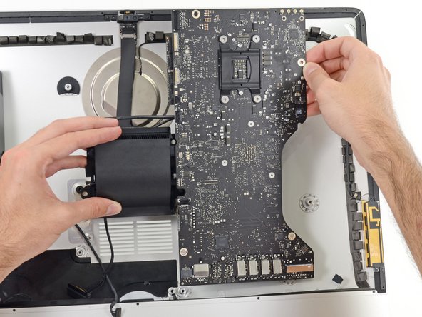

  37. iMac Intel 21.5" EMC 2544 Logic Board Replacement: crwdns2935265:037crwdnd2935265:01crwdnd2935265:03crwdne2935265:0 iMac Intel 21.5" EMC 2544 Logic Board Replacement: crwdns2935265:037crwdnd2935265:02crwdnd2935265:03crwdne2935265:0 iMac Intel 21.5" EMC 2544 Logic Board Replacement: crwdns2935265:037crwdnd2935265:03crwdnd2935265:03crwdne2935265:0
    • Pull the power supply slightly up and out from the rear enclosure.
    • Rotate the power supply counterclockwise, lifting the right side up about an inch higher than the left.
  38. iMac Intel 21.5" EMC 2544 Logic Board Replacement: crwdns2935265:038crwdnd2935265:01crwdnd2935265:02crwdne2935265:0 iMac Intel 21.5" EMC 2544 Logic Board Replacement: crwdns2935265:038crwdnd2935265:02crwdnd2935265:02crwdne2935265:0
    • Slide the power supply to the right to clear the screw posts on the rear enclosure.
  39. iMac Intel 21.5" EMC 2544 Logic Board Replacement: crwdns2935265:039crwdnd2935265:01crwdnd2935265:03crwdne2935265:0 iMac Intel 21.5" EMC 2544 Logic Board Replacement: crwdns2935265:039crwdnd2935265:02crwdnd2935265:03crwdne2935265:0 iMac Intel 21.5" EMC 2544 Logic Board Replacement: crwdns2935265:039crwdnd2935265:03crwdnd2935265:03crwdne2935265:0
    • Rock the power supply forward and remove it from its recess in the rear enclosure.
    • Do not try to completely remove the power supply from the iMac yet—it is still connected to the logic board.

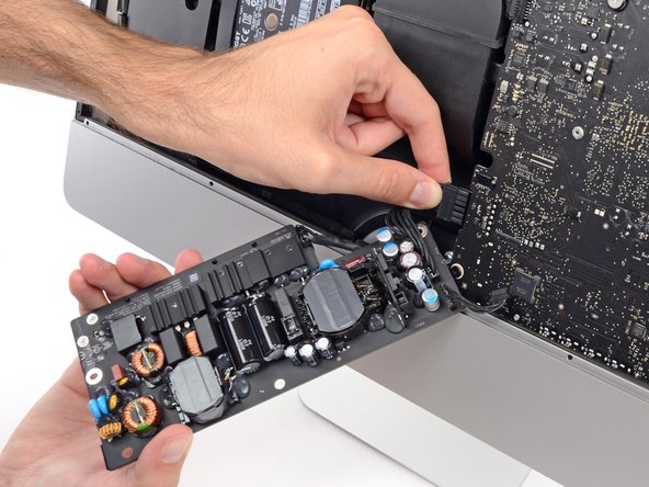

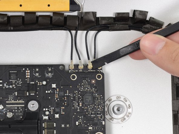

  40. iMac Intel 21.5" EMC 2544 Logic Board Replacement: crwdns2935265:040crwdnd2935265:01crwdnd2935265:02crwdne2935265:0 iMac Intel 21.5" EMC 2544 Logic Board Replacement: crwdns2935265:040crwdnd2935265:02crwdnd2935265:02crwdne2935265:0
    • Be very careful not to touch the capacitor leads or any exposed solder joints on the back of the power supply. Only handle the board by the edges.
    • Flip the top of the power supply towards you to access the DC power cable connection behind the logic board.
    • Squeeze the DC power cable connector tab and pull it straight out of its socket on the back of the logic board.

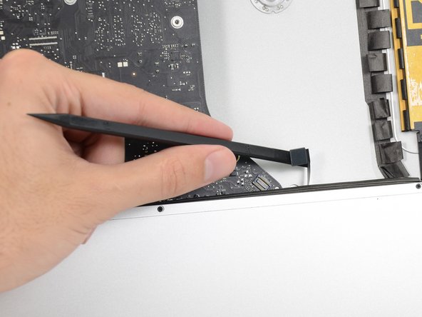

  41. iMac Intel 21.5" EMC 2544 Logic Board Replacement: crwdns2935265:041crwdnd2935265:01crwdnd2935265:03crwdne2935265:0 iMac Intel 21.5" EMC 2544 Logic Board Replacement: crwdns2935265:041crwdnd2935265:02crwdnd2935265:03crwdne2935265:0 iMac Intel 21.5" EMC 2544 Logic Board Replacement: crwdns2935265:041crwdnd2935265:03crwdnd2935265:03crwdne2935265:0
    • You may find it helpful to set the iMac down on its back on the table for the next couple of steps.
    • Use the flat end of a spudger to push the clip on the side of the AC inlet cable connector inward.
    • While holding on the release clip with the spudger, grasp the AC inlet cable, and pull the connector straight out of its socket.
  42. iMac Intel 21.5" EMC 2544 Logic Board Replacement: crwdns2935265:042crwdnd2935265:01crwdnd2935265:01crwdne2935265:0
    • Remove the power supply from the iMac.

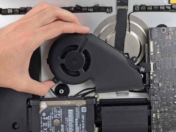

  43. iMac Intel 21.5" EMC 2544 Logic Board Replacement, Fan: crwdns2935265:043crwdnd2935265:01crwdnd2935265:02crwdne2935265:0 iMac Intel 21.5" EMC 2544 Logic Board Replacement, Fan: crwdns2935265:043crwdnd2935265:02crwdnd2935265:02crwdne2935265:0
    • Gently pull the fan cable connector straight away from its socket on the logic board.
  44. iMac Intel 21.5" EMC 2544 Logic Board Replacement: crwdns2935265:044crwdnd2935265:01crwdnd2935265:01crwdne2935265:0
    • Remove the three 12.3 mm T10 shoulder screws securing the fan to the rear enclosure.
  45. iMac Intel 21.5" EMC 2544 Logic Board Replacement: crwdns2935265:045crwdnd2935265:01crwdnd2935265:02crwdne2935265:0 iMac Intel 21.5" EMC 2544 Logic Board Replacement: crwdns2935265:045crwdnd2935265:02crwdnd2935265:02crwdne2935265:0
    • Remove the fan from the iMac.
  46. iMac Intel 21.5" EMC 2544 Logic Board Replacement, Hard Drive: crwdns2935265:046crwdnd2935265:01crwdnd2935265:03crwdne2935265:0 iMac Intel 21.5" EMC 2544 Logic Board Replacement, Hard Drive: crwdns2935265:046crwdnd2935265:02crwdnd2935265:03crwdne2935265:0 iMac Intel 21.5" EMC 2544 Logic Board Replacement, Hard Drive: crwdns2935265:046crwdnd2935265:03crwdnd2935265:03crwdne2935265:0
    • Lift the hard drive from the edge nearest the logic board and pull it slightly out of its recess.
    • The hard drive is attached by two cables, do not attempt to fully remove it from the iMac.
  47. iMac Intel 21.5" EMC 2544 Logic Board Replacement: crwdns2935265:047crwdnd2935265:01crwdnd2935265:02crwdne2935265:0 iMac Intel 21.5" EMC 2544 Logic Board Replacement: crwdns2935265:047crwdnd2935265:02crwdnd2935265:02crwdne2935265:0
    • Disconnect the SATA power cable.
  48. iMac Intel 21.5" EMC 2544 Logic Board Replacement: crwdns2935265:048crwdnd2935265:01crwdnd2935265:02crwdne2935265:0 iMac Intel 21.5" EMC 2544 Logic Board Replacement: crwdns2935265:048crwdnd2935265:02crwdnd2935265:02crwdne2935265:0
    • Unplug the SATA data cable from the hard drive.

    • Push on each side of the left speaker cable connector with the tip of a spudger and gently "walk" it out of its socket.
  53. iMac Intel 21.5" EMC 2544 Logic Board Replacement: crwdns2935265:053crwdnd2935265:01crwdnd2935265:02crwdne2935265:0 iMac Intel 21.5" EMC 2544 Logic Board Replacement: crwdns2935265:053crwdnd2935265:02crwdnd2935265:02crwdne2935265:0
    • De-route the left speaker cable by pulling it straight up out of the retaining clip in the back of the rear enclosure.
  54. iMac Intel 21.5" EMC 2544 Logic Board Replacement: crwdns2935265:054crwdnd2935265:01crwdnd2935265:03crwdne2935265:0 iMac Intel 21.5" EMC 2544 Logic Board Replacement: crwdns2935265:054crwdnd2935265:02crwdnd2935265:03crwdne2935265:0 iMac Intel 21.5" EMC 2544 Logic Board Replacement: crwdns2935265:054crwdnd2935265:03crwdnd2935265:03crwdne2935265:0
    • In a similar fashion as the previous step, de-route the SATA data and power cables up out of the retaining clip.

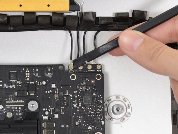

    • Use the flat edge of a spudger to disconnect each of the four antenna connectors from the AirPort/Bluetooth card.
    • Note the original positions for each connector when reconnecting the cables.
  57. iMac Intel 21.5" EMC 2544 Logic Board Replacement: crwdns2935265:057crwdnd2935265:01crwdnd2935265:01crwdne2935265:0
    • If brackets secure the four antenna cables, remove the two T5 Torx screws from the brackets.

    • Use the flat edge of a spudger to pry the headphone jack cable connector from its socket on the logic board.
    • Push the cable slightly to the right.

    • Remove the four 7.2 mm T10 screws securing the logic board to the rear enclosure.
    • Depending on the age and model of your iMac, a T9 driver may work best.

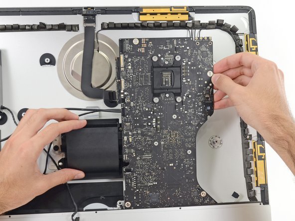

  61. iMac Intel 21.5" EMC 2544 Logic Board Replacement: crwdns2935265:061crwdnd2935265:01crwdnd2935265:03crwdne2935265:0 iMac Intel 21.5" EMC 2544 Logic Board Replacement: crwdns2935265:061crwdnd2935265:02crwdnd2935265:03crwdne2935265:0 iMac Intel 21.5" EMC 2544 Logic Board Replacement: crwdns2935265:061crwdnd2935265:03crwdnd2935265:03crwdne2935265:0
    • Tilt the top of the logic board away from the rear enclosure.
    • Lift the logic board straight up and out of the iMac.
    • Be careful not to snag the board on any of the rear case's screw posts.
    • The I/O boards at the bottom of the logic board will be the greatest challenge. It is recommended to pull gently to avoid any damage.
    • During reassembly of the logic board, pay attention to the position of the I/O connectors. When the board is back in the case, insert a USB or Thunderbolt cable into one of the connectors to align it perfectly.

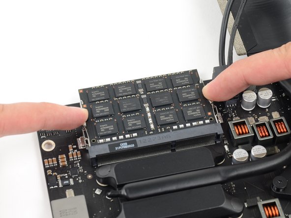

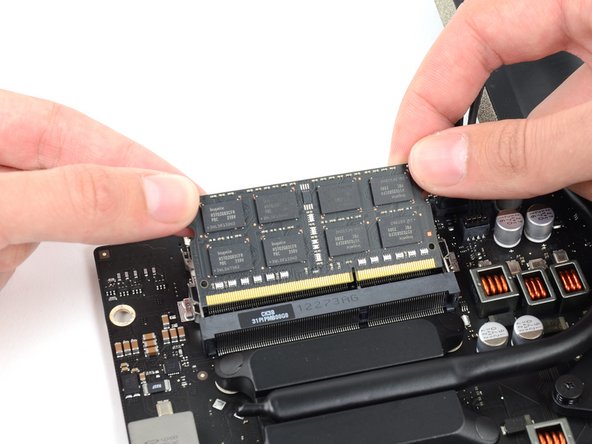

  62. iMac Intel 21.5" EMC 2544 Logic Board Replacement, RAM: crwdns2935265:062crwdnd2935265:01crwdnd2935265:03crwdne2935265:0 iMac Intel 21.5" EMC 2544 Logic Board Replacement, RAM: crwdns2935265:062crwdnd2935265:02crwdnd2935265:03crwdne2935265:0 iMac Intel 21.5" EMC 2544 Logic Board Replacement, RAM: crwdns2935265:062crwdnd2935265:03crwdnd2935265:03crwdne2935265:0
    • Release the tabs on each side of the RAM module by simultaneously pushing each tab away.
    • The RAM module should pop up slightly from its socket.
    • Grab the top left and right corners of the RAM module and carefully pull it straight out of its socket.
    • Repeat the process to remove additional RAM modules as necessary.

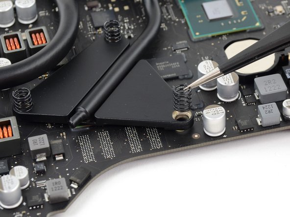

    • Remove the three 12 mm T8 Torx screws securing the GPU heat sink to the logic board.
    • Remove the three springs left behind.
    • These springs might come up with the screws; be careful not to lose track of them.

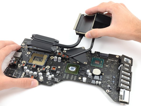

  68. iMac Intel 21.5" EMC 2544 Logic Board Replacement: crwdns2935265:068crwdnd2935265:01crwdnd2935265:02crwdne2935265:0 iMac Intel 21.5" EMC 2544 Logic Board Replacement: crwdns2935265:068crwdnd2935265:02crwdnd2935265:02crwdne2935265:0
    • Lift and remove the heat sink up off the logic board.
    • The CPU will most likely detach with the heat sink, so be careful about where you lay it down.

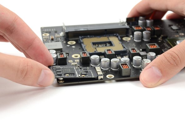

  71. iMac Intel 21.5" EMC 2544 Logic Board Replacement, Logic Board: crwdns2935265:071crwdnd2935265:01crwdnd2935265:01crwdne2935265:0
