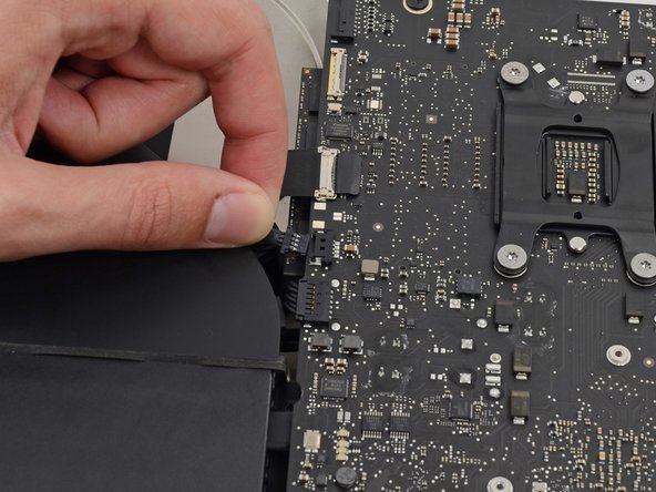

  29. iMac Intel 21.5" EMC 2544 Left Speaker Replacement, Left Speaker: crwdns2935265:029crwdnd2935265:01crwdnd2935265:02crwdne2935265:0 iMac Intel 21.5" EMC 2544 Left Speaker Replacement, Left Speaker: crwdns2935265:029crwdnd2935265:02crwdnd2935265:02crwdne2935265:0
    • Gently pull the left speaker cable straight out of its socket on the logic board.
  30. iMac Intel 21.5" EMC 2544 Left Speaker Replacement: crwdns2935265:030crwdnd2935265:01crwdnd2935265:01crwdne2935265:0
    • De-route the left speaker cable by pulling it straight up out of the retaining clip in the back of the rear enclosure.
