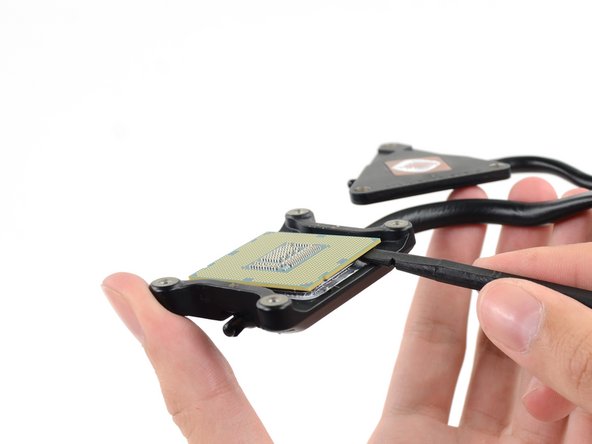

iMac Intel 21.5" EMC 2544 CPU Replacement
  1. iMac Intel 21.5" EMC 2544 CPU Replacement, Display: crwdns2935265:01crwdnd2935265:01crwdnd2935265:01crwdne2935265:0
    iMac Intel 21.5" Cardboard Service Wedge
    • With the hinge free to move, the iMac will be unbalanced and hard to work on. Repairs can be completed as shown, but are faster and easier with an iMac service wedge.
    • If you are using the iFixit cardboard service wedge, follow these assembly directions to put it together.
    • Before beginning any work on your iMac: Unplug the computer and press and hold the power button for ten seconds to discharge the power supply's capacitors.
    • Be very careful not to touch the capacitor leads or any exposed solder joints on the back of the power supply. Only handle the board by the edges.
  2. iMac Intel 21.5" EMC 2544 CPU Replacement: crwdns2935265:02crwdnd2935265:01crwdnd2935265:02crwdne2935265:0 iMac Intel 21.5" EMC 2544 CPU Replacement: crwdns2935265:02crwdnd2935265:02crwdnd2935265:02crwdne2935265:0

  69. iMac Intel 21.5" EMC 2544 CPU Replacement, CPU: crwdns2935265:069crwdnd2935265:01crwdnd2935265:02crwdne2935265:0 iMac Intel 21.5" EMC 2544 CPU Replacement, CPU: crwdns2935265:069crwdnd2935265:02crwdnd2935265:02crwdne2935265:0
    • The CPU will most likely be stuck to the heat sink with thermal compound.
    • Insert the flat edge of a spudger between the CPU and heat sink.
    • Gently pry the CPU off the heat sink by slightly twisting the spudger upwards.
  70. iMac Intel 21.5" EMC 2544 CPU Replacement: crwdns2935265:070crwdnd2935265:01crwdnd2935265:01crwdne2935265:0
    • Remove the CPU from the heat sink. Be careful not to touch the contacts.
    • To install a new CPU, see our thermal paste guide for instructions on cleaning and preparing the thermal surfaces and applying a new layer of thermal compound onto the CPU and GPU dies.
