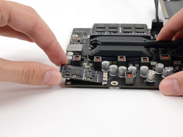

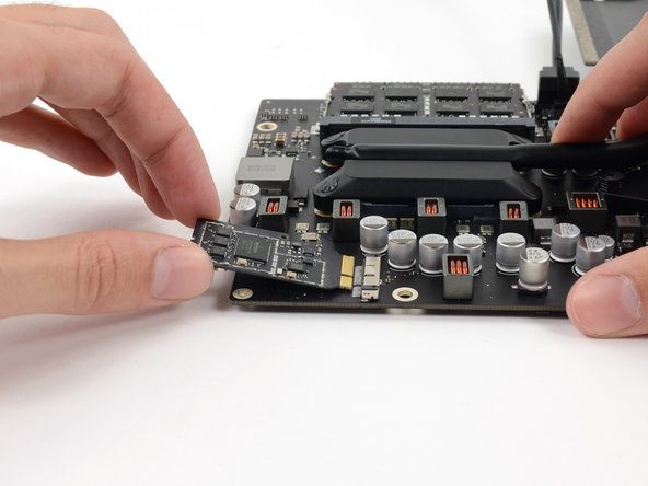

  61. iMac Intel 21.5" EMC 2544 AirPort/Bluetooth Card Replacement: crwdns2935265:061crwdnd2935265:01crwdnd2935265:03crwdne2935265:0 iMac Intel 21.5" EMC 2544 AirPort/Bluetooth Card Replacement: crwdns2935265:061crwdnd2935265:02crwdnd2935265:03crwdne2935265:0 iMac Intel 21.5" EMC 2544 AirPort/Bluetooth Card Replacement: crwdns2935265:061crwdnd2935265:03crwdnd2935265:03crwdne2935265:0
    • Slightly lift the AirPort/Bluetooth card and pull it straight out its socket.
    • Do not use excessive force to pull the end of the AirPort/Bluetooth Card away from its socket on the logic board. Doing so may damage the socket.
    • When reinstalling the card, be sure it is properly seated before reinstalling the retaining screws.
To reassemble your device, follow these instructions in reverse and use our Adhesive Strips Guide to reattach the display glass.
