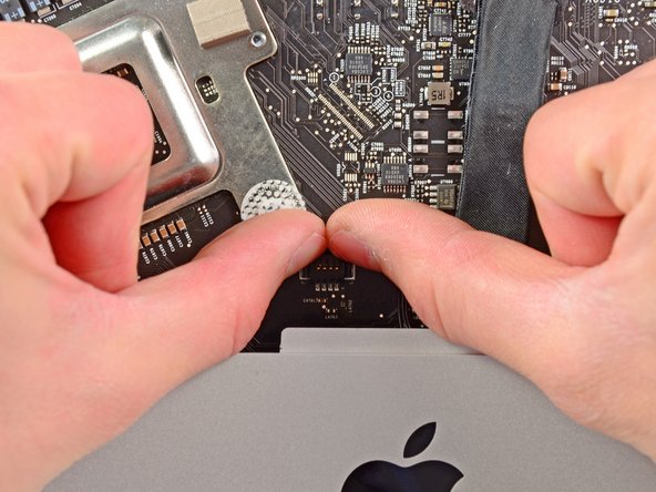

  7. iMac Intel 21.5" EMC 2428 IR Board Replacement: crwdns2935265:07crwdnd2935265:01crwdnd2935265:03crwdne2935265:0 iMac Intel 21.5" EMC 2428 IR Board Replacement: crwdns2935265:07crwdnd2935265:02crwdnd2935265:03crwdne2935265:0 iMac Intel 21.5" EMC 2428 IR Board Replacement: crwdns2935265:07crwdnd2935265:03crwdnd2935265:03crwdne2935265:0
    • Grab the plastic pull tab secured to the display data cable lock and rotate it towards upwards.
    • Pull the display data cable straight out of its socket on the logic board.
    • Do not lift up on the display data cable, as its socket is very fragile. Pull the cable parallel to the face of the logic board.
