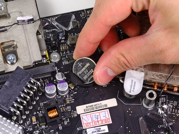

  39. iMac Intel 21.5" EMC 2389 PRAM Battery Replacement: crwdns2935265:039crwdnd2935265:01crwdnd2935265:01crwdne2935265:0
    • Remove the plastic pressure wall installed next to the hard drive.
  40. iMac Intel 21.5" EMC 2389 PRAM Battery Replacement: crwdns2935265:040crwdnd2935265:01crwdnd2935265:02crwdne2935265:0 iMac Intel 21.5" EMC 2389 PRAM Battery Replacement: crwdns2935265:040crwdnd2935265:02crwdnd2935265:02crwdne2935265:0
    • Slightly pull the logic board away from the back of the outer case, then lift it upward to clear the lower front face of the outer case.
  41. iMac Intel 21.5" EMC 2389 PRAM Battery Replacement: crwdns2935265:041crwdnd2935265:01crwdnd2935265:01crwdne2935265:0
    • Disconnect the audio port cable by pulling its connector away from the front face of the logic board.
  42. iMac Intel 21.5" EMC 2389 PRAM Battery Replacement: crwdns2935265:042crwdnd2935265:01crwdnd2935265:01crwdne2935265:0
    • If present, peel off the tape securing the hard drive SATA cable to the logic board.
  43. iMac Intel 21.5" EMC 2389 PRAM Battery Replacement: crwdns2935265:043crwdnd2935265:01crwdnd2935265:02crwdne2935265:0 iMac Intel 21.5" EMC 2389 PRAM Battery Replacement: crwdns2935265:043crwdnd2935265:02crwdnd2935265:02crwdne2935265:0

  45. iMac Intel 21.5" EMC 2389 PRAM Battery Replacement, PRAM Battery: crwdns2935265:045crwdnd2935265:01crwdnd2935265:02crwdne2935265:0 iMac Intel 21.5" EMC 2389 PRAM Battery Replacement, PRAM Battery: crwdns2935265:045crwdnd2935265:02crwdnd2935265:02crwdne2935265:0
    • Use the tip of a spudger to pry the PRAM battery out of its socket on the logic board.
    • The PRAM battery is a BR2032 lithium coin cell.

Andrew, could a bad PRAM battery cause the iMac to not start at all? I just replaced the PSU, and still dead. I have an iMac A1311 EMC2389. Thanks.
agigante - crwdns2934203:0crwdne2934203:0
Yes. This is quite common with Macs, but the battery usually lasts a long time, especially if the machine is on most of the time.
