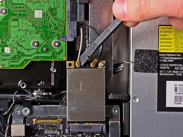

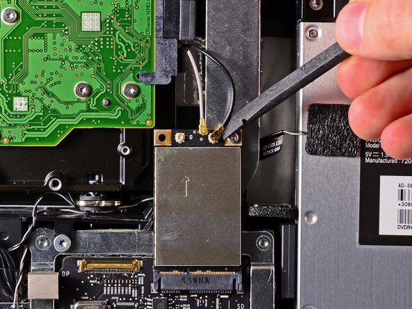

  10. iMac Intel 21.5" EMC 2389 AirPort Card Replacement, AirPort Card: crwdns2935265:010crwdnd2935265:01crwdnd2935265:03crwdne2935265:0 iMac Intel 21.5" EMC 2389 AirPort Card Replacement, AirPort Card: crwdns2935265:010crwdnd2935265:02crwdnd2935265:03crwdne2935265:0 iMac Intel 21.5" EMC 2389 AirPort Card Replacement, AirPort Card: crwdns2935265:010crwdnd2935265:03crwdnd2935265:03crwdne2935265:0
    • Use the flat end of a spudger to pry both AirPort antenna cable connectors up from their sockets on the AirPort card.
    • During reassembly, connect the gray antenna to the socket on the left and the black antenna to the socket on the right.
