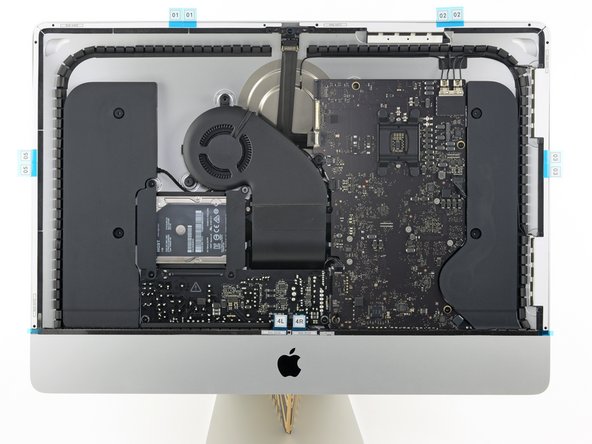

  4. iMac Intel 21.5" Display Adhesive Strips Replacement (Custom Notch), Lay out the adhesive strips: crwdns2935265:04crwdnd2935265:01crwdnd2935265:02crwdne2935265:0 iMac Intel 21.5" Display Adhesive Strips Replacement (Custom Notch), Lay out the adhesive strips: crwdns2935265:04crwdnd2935265:02crwdnd2935265:02crwdne2935265:0
    • Lay out the adhesives strips beforehand so you won't accidentally install a strip in the wrong place:
    • Strip 01 on the top left
    • Strip 02 on the top right
    • Strip 03 on the right vertical
    • Strip 4R on the bottom right, dark side facing up
    • Strip 4L on the bottom left, dark side facing up
    • Strip 5 on the left vertical

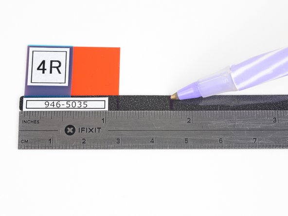

  12. iMac Intel 21.5" Display Adhesive Strips Replacement (Custom Notch), Cut the microphone notch: crwdns2935265:012crwdnd2935265:01crwdnd2935265:01crwdne2935265:0
    • To avoid blocking the microphone port with adhesive, strip 4R must be modified before use. A small notch must be cut out of the lower edge of the adhesive strip to accommodate the microphones.

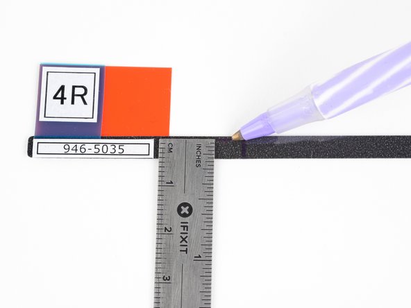

  13. iMac Intel 21.5" Display Adhesive Strips Replacement (Custom Notch): crwdns2935265:013crwdnd2935265:01crwdnd2935265:03crwdne2935265:0 iMac Intel 21.5" Display Adhesive Strips Replacement (Custom Notch): crwdns2935265:013crwdnd2935265:02crwdnd2935265:03crwdne2935265:0 iMac Intel 21.5" Display Adhesive Strips Replacement (Custom Notch): crwdns2935265:013crwdnd2935265:03crwdnd2935265:03crwdne2935265:0
    • Measuring from the left end of strip 4R (the end with the labels) make two marks on the strip as guides for where to cut.
    • Make the first mark 1⅛ inches (28.6 mm) from the left edge.
    • Make the next mark 1¾ inches (44.5 mm) from the left edge.
    • Measuring from the bottom edge of the strip, make a third mark in between the first two 5/32 inches (4 mm) up from the bottom edge.
    • This cut will be very close to the top edge of the adhesive strip, but it's important that you leave material over top of the adhesive strip for proper sound isolation. When in doubt, remove less material than you think you need to. If the adhesive still covers the microphone you can always make the notch bigger.
    iMac 2015 model doesn’t have a microphone hole where the adhesive goes ? Is it then necessary to cut a notch ?
    Arnoud - crwdns2934203:0crwdne2934203:0
    Nope! If the iMac does not have a microphone hole, don’t cut a notch.
    Arthur Shi -
    The instructions state to mark a line (5/8), but 5/8ths would be larger than the strip itself. The actual measurement on the photo displayed above is 5/32nds.
    Clay - crwdns2934203:0crwdne2934203:0
    Hi Clay,
    Nice catch! I’ll correct that now!
    Arthur Shi -

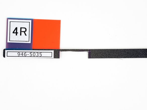

  14. iMac Intel 21.5" Display Adhesive Strips Replacement (Custom Notch): crwdns2935265:014crwdnd2935265:01crwdnd2935265:02crwdne2935265:0 iMac Intel 21.5" Display Adhesive Strips Replacement (Custom Notch): crwdns2935265:014crwdnd2935265:02crwdnd2935265:02crwdne2935265:0
    • Very carefully cut along the marks you made with a pair of scissors or a razor blade.
    • After cutting, your microphone notch should look like the one in the second photo.
    • Before removing the backing, place your adhesive strip on the iMac and make sure the notch lines up with the microphones.
