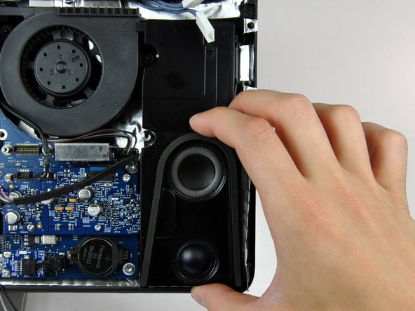

    • Remove the single 28 mm T10 Torx screw securing the left speaker to the rear case.
    • Lift the left speaker up and out of the rear case. Don't try to slide the speaker out, since there is a plastic mounting pin under the top end of the speaker housing that holds it in place.

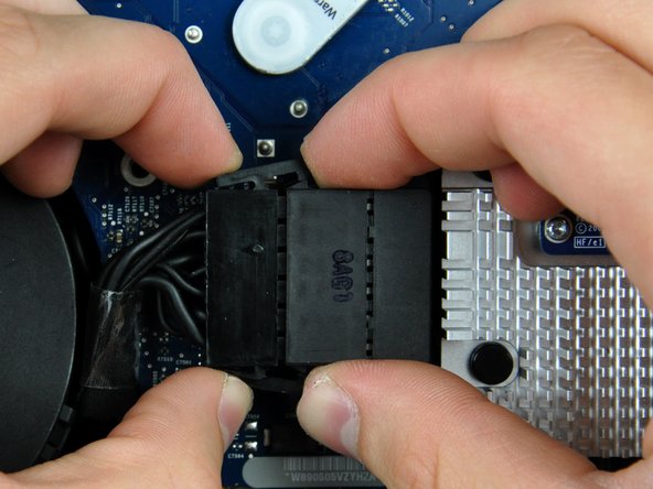

    • Disconnect the SATA data cable from the logic board by carefully pulling it straight away from its socket.
    • The SATA connector on most iMacs tends to stick in its socket on the logic board. If you are having trouble disconnecting the SATA cable, insert a metal spudger or any other thin tool into the gap between the SATA connector and its socket and twist the spudger's shaft to safely separate the two pieces.

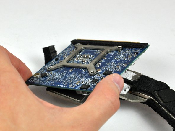

  40. iMac Intel 20" EMC 2133 and 2210 Video Card Replacement: crwdns2935265:040crwdnd2935265:01crwdnd2935265:02crwdne2935265:0 iMac Intel 20" EMC 2133 and 2210 Video Card Replacement: crwdns2935265:040crwdnd2935265:02crwdnd2935265:02crwdne2935265:0
    • Gently lift the video card off the video card heat sink.

    • Be sure to apply a new layer of thermal paste to the face of the graphics processor (shown in red).
    • We have a thermal paste guide that makes reapplying thermal compound simple.
    • Before reattaching your video card heat sink, use the flat end of a spudger to re-spread the thermal compound over the face of both video RAM chips (shown in green).
    • If you are upgrading to the 256MB ATI Radeon HD 2600XT (Apple P/N 661-4436), you will need more thermal compound (i.e. K5 Pro) for the two extra RAM chips (shown in green). You can find the GPU upgrade guide here: GPU Upgrade for 20" iMac (mid 2007))
