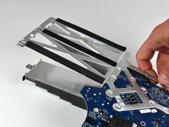

  35. iMac Intel 20" EMC 2133 and 2210 CPU Replacement, Heat Sink : crwdns2935265:035crwdnd2935265:01crwdnd2935265:01crwdne2935265:0
    • Disconnect the heat sink temperature sensor connector by pulling it straight up from its socket on the logic board.
  36. iMac Intel 20" EMC 2133 and 2210 CPU Replacement: crwdns2935265:036crwdnd2935265:01crwdnd2935265:01crwdne2935265:0
    • Flip the logic board over so it is heat sink side down.
    • If necessary, remove the clear tape covering the heat sink bracket.
  37. iMac Intel 20" EMC 2133 and 2210 CPU Replacement: crwdns2935265:037crwdnd2935265:01crwdnd2935265:01crwdne2935265:0
    • Remove the four fine-thread 5 mm T8 Torx screws securing the heat sink to the logic board.
  38. iMac Intel 20" EMC 2133 and 2210 CPU Replacement: crwdns2935265:038crwdnd2935265:01crwdnd2935265:01crwdne2935265:0
    • Remove the 4.3 mm T10 Torx screw securing the heat sink to the heat sink bracket.
  39. iMac Intel 20" EMC 2133 and 2210 CPU Replacement: crwdns2935265:039crwdnd2935265:01crwdnd2935265:02crwdne2935265:0 iMac Intel 20" EMC 2133 and 2210 CPU Replacement: crwdns2935265:039crwdnd2935265:02crwdnd2935265:02crwdne2935265:0
    • Gently press the heat sink away from the heat sink bracket to separate it from the logic board.
    • Lift the logic board off the heat sink.
    • If you need to mount the heat sink back into the iMac, we have a thermal paste guide that makes replacing the thermal compound easy.
