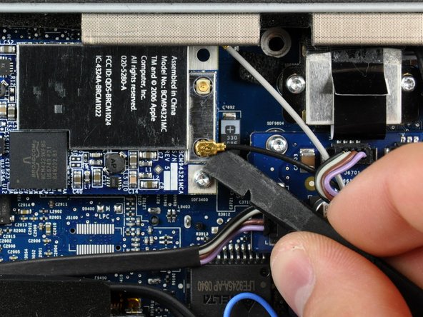

  7. iMac Intel 20" EMC 2133 and 2210 AirPort Extreme Replacement, AirPort Extreme: crwdns2935265:07crwdnd2935265:01crwdnd2935265:02crwdne2935265:0 iMac Intel 20" EMC 2133 and 2210 AirPort Extreme Replacement, AirPort Extreme: crwdns2935265:07crwdnd2935265:02crwdnd2935265:02crwdne2935265:0
    • Use the flat end of a spudger to pry both antenna connectors up off the AirPort Extreme card.
