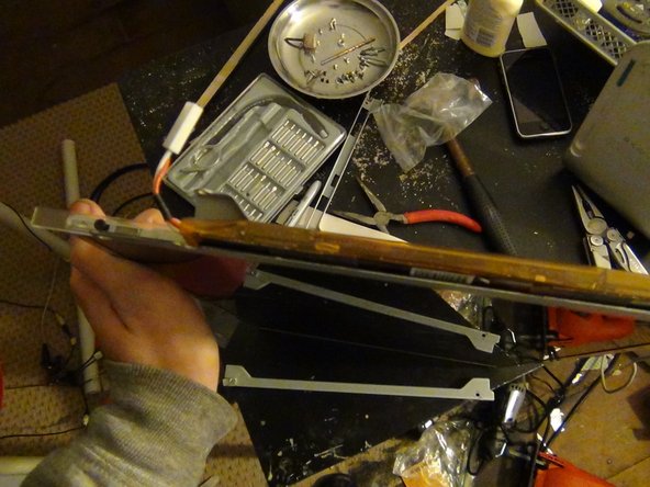

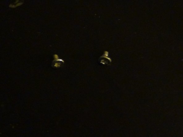

    • Next we will remove the metal screen brackets. Each side is held on by 2 Torx screws. Remove these screws, remove the brackets, and put them aside. You will need 2 of them later.

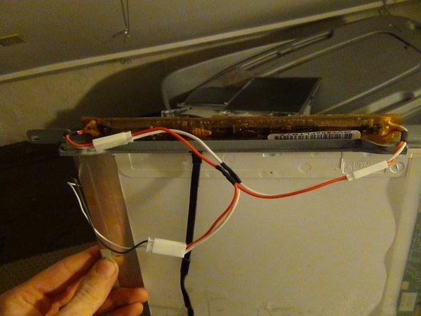

    • In your Unimac Version 2 kit, you will find 2 plastic spacers, one is much larger then the other. The thinner one will go on the "inverter side" of the screen, the other will go on the opposite side.
    • You will also find 4 small black screws.
    • Use the small screws to attach the non inverter spacer as shown in the picture.It has slots to allow for height adjustment, no matter how you mount it, its going to be close to centered, but later in the guide we will get it perfect. Attach the metal bracket to the spacer with the torx screws as shown.
    • Take the inverter (metal) bracket, and remove the inverter, but dont pull out the cable.(you will just have to put it back in place anyway) It is held in with some adhesive and should come out easily, just dont break it.
    • Slide the metal bracket in place, and secure the spacer as shown. Put the inverter back in its orignal place.

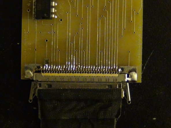

    • Adapter Installation:
    • Install the pre-folded(dont unfold it) FFC Cable into the replacement LCD screen as shown. If you happen to have a non-locking style screen connector, you must cut off the lock tabs on the FFC cable. I highly recommend getting a screen with a locking connector.
    • Install the UniMac Adapter as shown. The FFC cable will slide into the recepticle, it is a standard "slide lock" style recepticle.
    • Use the double sided adhesive on the underside of the adapter to attach it to the back of the lcd screen.
    • Install the lvds cable into the adapter. You will feel it lock into place. Be sure not to attempt to install the cable upside down. The contacts are on the bottom, install the cable as such.
    • Cover all connections with clear plastic tape, to ensure nothing can possibly short anything else out. DO NOT IGNORE THIS STEP.
