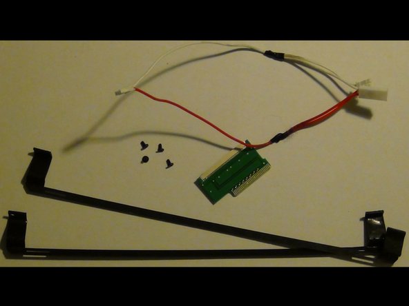

    • What you will need to complete this install:
    • Contents of UniMac V4 Adapter Kit:
    • UniMac V4 Adapter
    • Mounting brackets
    • CCFL Adapter
    • Phillips Screws
    • Required tools listed prior, compatible LCD panel, insulation tape (clear packing tape works well)
  15. iMac Intel 17" UniMac V4 Adapter Kit: crwdns2935265:015crwdnd2935265:01crwdnd2935265:03crwdne2935265:0 iMac Intel 17" UniMac V4 Adapter Kit: crwdns2935265:015crwdnd2935265:02crwdnd2935265:03crwdne2935265:0 iMac Intel 17" UniMac V4 Adapter Kit: crwdns2935265:015crwdnd2935265:03crwdnd2935265:03crwdne2935265:0

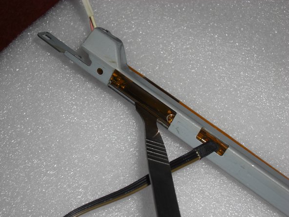

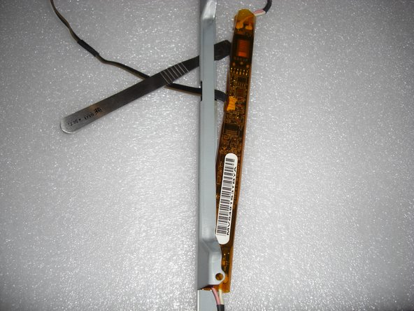

    • Remove both metal brackets from the original LCD screen.
    • Remove 2 torx screws from each side. Each bracket should then be easily removed.

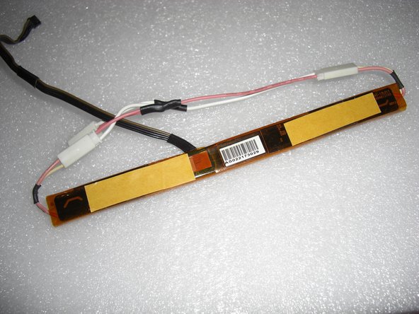

    • Remove the LCD inverter from the metal bracket. It is held in with some light adhesive.
    • You can use a spudger to lift the inverter board slightly. Then it will come out easily.

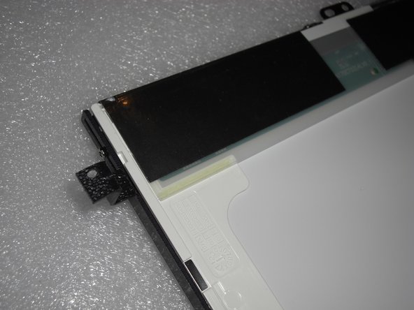

    • Attach the included plastic adapters to the replacement LCD screen.
    • These must be used because the replacement screen is likely much thinner than the OEM panel.
    • The adapter with the larger leg space has to be mounted on the "right" side of the LCD. That's where the LVDS connector is located.
    • The brackets screw directly to the screen using the included phillips screws.
  17. iMac Intel 17" UniMac V4 Adapter Kit: crwdns2935265:017crwdnd2935265:01crwdnd2935265:03crwdne2935265:0 iMac Intel 17" UniMac V4 Adapter Kit: crwdns2935265:017crwdnd2935265:02crwdnd2935265:03crwdne2935265:0 iMac Intel 17" UniMac V4 Adapter Kit: crwdns2935265:017crwdnd2935265:03crwdnd2935265:03crwdne2935265:0

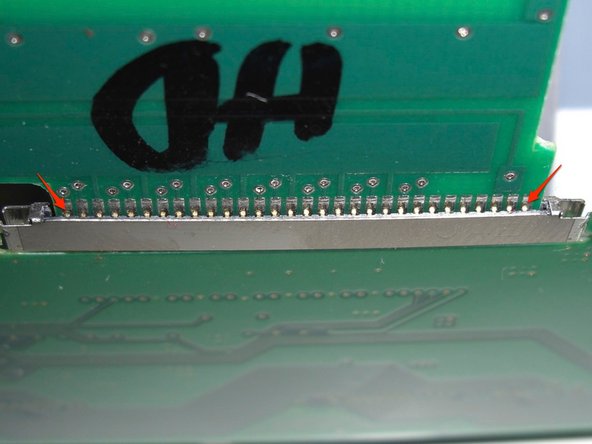

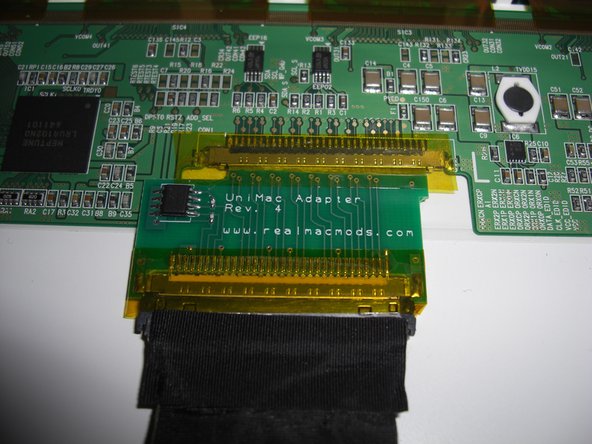

    • Attach the UniMac V4 Adapter to the LCD screen.
    • Simply clip it into the LVDS socket.
    • Ensure a solid connection and then put a piece of packing tape over the adapter.
    • Attach the LVDS cable, that you removed earlier, to the UniMac V4 Adapter. Ensure a solid connection and put a piece of packing tape over it.
    • Check the contact alignment. The contact springs have to be all in the right place! Generally, if the most outer pins are properly seated, the other pins will fit, too.

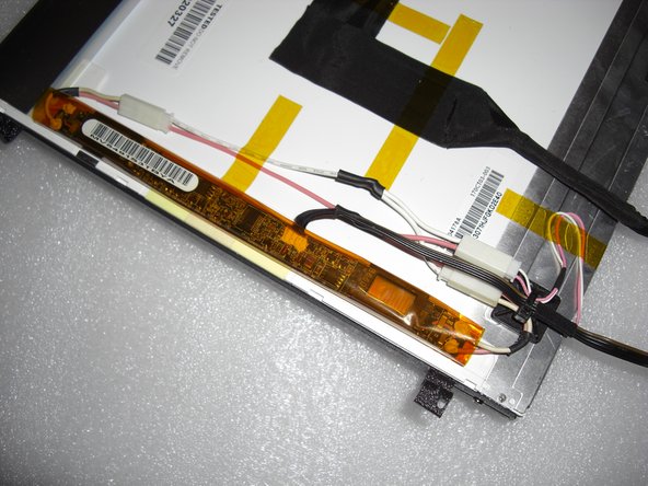

    • Attach the included CCFL adapter to the original inverter board.
    • Apply some self adhesive tape at the bottom of the board.
  19. iMac Intel 17" UniMac V4 Adapter Kit: crwdns2935265:019crwdnd2935265:01crwdnd2935265:02crwdne2935265:0 iMac Intel 17" UniMac V4 Adapter Kit: crwdns2935265:019crwdnd2935265:02crwdnd2935265:02crwdne2935265:0
    • Fix the LVDS cable with some adhesive tape. This reduces mechanical force applied to the UniMac Adapter and makes the modification more stable.
    • Now place the inverter board at the left side of the LCD. There's enough room between the CD-ROM drive and the LCD, so there's the optimal place.
    • You should now have a fully assembled display ready for install.
    • Be very careful not to apply too much force when attaching the adhesive tape. The back of the LCD is very sensitive!

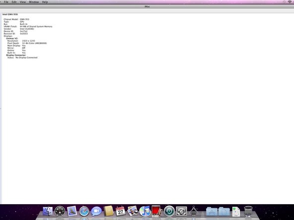

    • Reassembly and test:
    • Double check everything and once you are confident everything went well, install the front bezel.
    • Attach the power cable, and hit the power button.
    • You should now be greeted by a white screen and the Apple logo.
    • It should now be apparent if any alignment adjustments need to be made.
