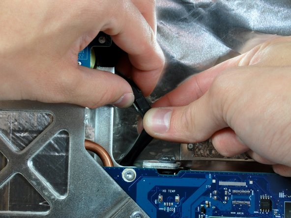

    3. iMac Intel 17" Power Supply Replacement: crwdns2935265:010crwdnd2935265:01crwdnd2935265:01crwdne2935265:0
      • Inverter cable on 24inch iMac pulls off to the left.
      • Pull the inverter cable connector straight up off its socket on the logic board.
