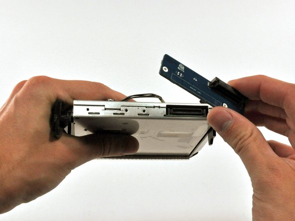

      • Remove the two T6 Torx screws securing the connector board to the optical drive.
      • Pull the connector board away from the optical drive.

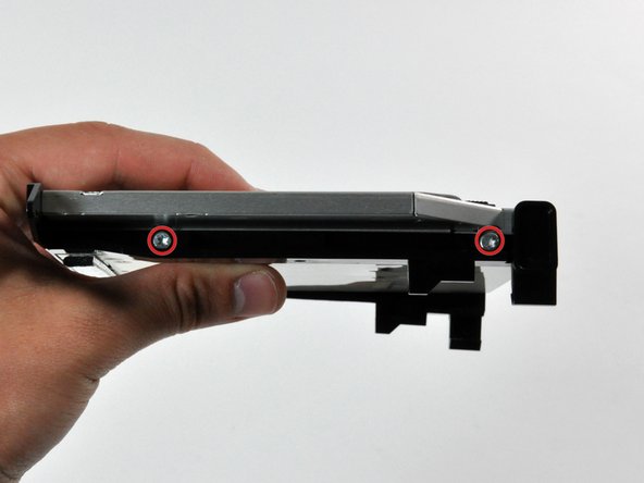

      • Remove the two T10 Torx screws from each side of the optical drive (four screws total).

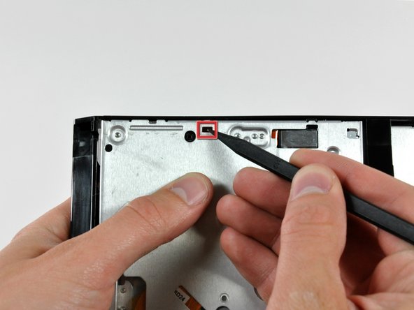

      • Use the sharp end of a spudger to push the optical drive bracket tabs out of their slots on the bottom of the optical drive.
    5. iMac Intel 17" Optical Drive Replacement: crwdns2935265:022crwdnd2935265:01crwdnd2935265:01crwdne2935265:0

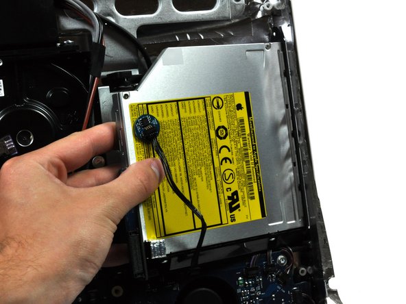

      • Use the flat end of a spudger to pry the optical drive thermal sensor off the adhesive holding it to the top of the optical drive.
      • Don't forget to transfer this to your new drive.
