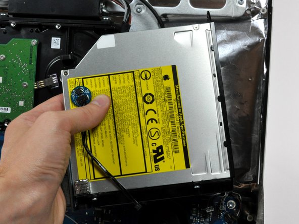

  28. iMac Intel 17" Logic Board Replacement: crwdns2935265:028crwdnd2935265:01crwdnd2935265:02crwdne2935265:0 iMac Intel 17" Logic Board Replacement: crwdns2935265:028crwdnd2935265:02crwdnd2935265:02crwdne2935265:0
    • Squeeze the two optical drive bracket ears together while pulling the drive up toward yourself.
    • It may be helpful to hold the logic board down near the optical drive connector when pulling the drive toward yourself to avoid both components lifting together.
    • Pull the optical drive away from the side of the rear case and remove it from the iMac.
    • If your optical drive is particularly stubborn to remove, try the method used in the optical drive guide from the A1144 G5 iMac.
