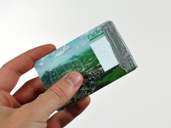

    • Insert a plastic card up into the corner of the air vent slot near the top of the rear case.
    • Push the card toward the top of the iMac to release the front bezel latch.
    • Pull the front bezel away from the rear case.
    • Repeat this process for the other side of the front bezel.
    • It may be necessary to apply several layers of duct tape to the top of the access card to aid in releasing the latches.
    • If the bezel refuses to release, try pressing the lower edge back onto the rear case and repeat this opening process.

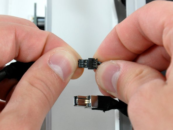

    • Disconnect both the camera and microphone cables.

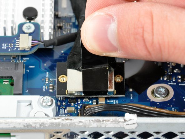

    • Remove the two 4.8 mm T6 Torx screws securing the display data cable to the logic board.
    • Grab the display data cable connector by its black tab and pull it straight up off the logic board.

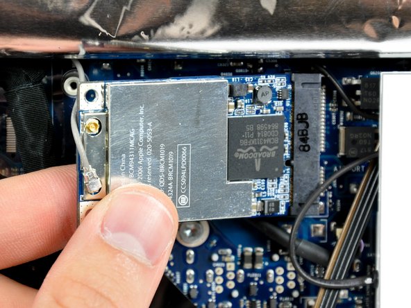

    • Remove the two 4.8 mm T6 Torx screws securing the AirPort Extreme card to the logic board.
    • Lift the free end slightly and pull the AirPort Extreme card straight away from its socket.
  11. iMac Intel 17" AirPort Extreme Replacement: crwdns2935265:011crwdnd2935265:01crwdnd2935265:01crwdne2935265:0
    • Use a spudger to pry the antenna connector up off the AirPort Extreme card.
