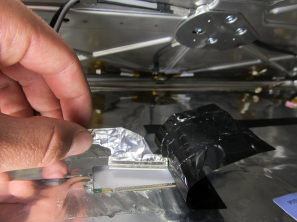

  7. iMac G4 17 800 MHz EMC 1936 LCD Replacement: crwdns2935265:07crwdnd2935265:01crwdnd2935265:02crwdne2935265:0 iMac G4 17 800 MHz EMC 1936 LCD Replacement: crwdns2935265:07crwdnd2935265:02crwdnd2935265:02crwdne2935265:0
    • The third, and final, cable you will need to unplug is the TMDS connector. This is located under a rectangular strip of black tape that has a gray and black cord coming out of one end.
    • Peel back the black tape, starting at the end with the cords protruding out.
    • Under the black tape, you will see the gray and black cords going into a connection that looks like it is wrapped in aluminum foil. Grasp that connection and pull carefully in the downward direction toward the bottom of the display.
