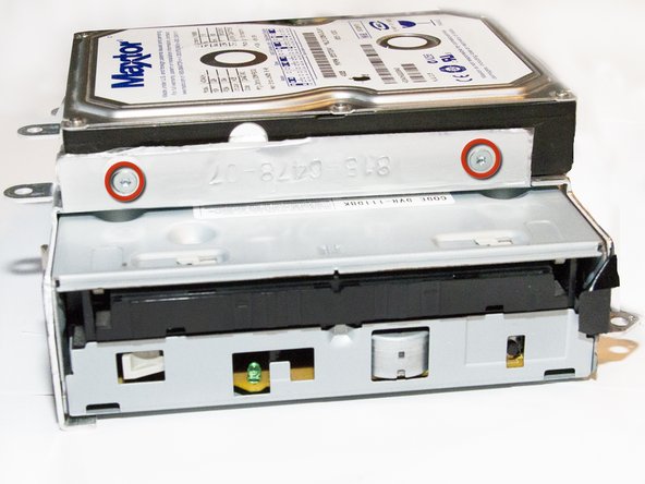

  14. iMac G4 15" 700 MHz EMC 1873 Hard Drive Replacement: crwdns2935265:014crwdnd2935265:01crwdnd2935265:01crwdne2935265:0
    • Remove the four 6.75mm Torx # 10 screws mounting the drive.
    • There are two screws on both sides of drive mount.
  15. iMac G4 15" 700 MHz EMC 1873 Hard Drive Replacement: crwdns2935265:015crwdnd2935265:01crwdnd2935265:01crwdne2935265:0
    • Slide the optical drive out from the metal support mounted to hard drive.
  16. iMac G4 15" 700 MHz EMC 1873 Hard Drive Replacement, Hard Drive: crwdns2935265:016crwdnd2935265:01crwdnd2935265:02crwdne2935265:0 iMac G4 15" 700 MHz EMC 1873 Hard Drive Replacement, Hard Drive: crwdns2935265:016crwdnd2935265:02crwdnd2935265:02crwdne2935265:0
    • Using a Torx #10 screw driver, remove the four 6.03mm screws mounting the hard drive to the assembly.
    • There are two screws mounting the drive on each side.
