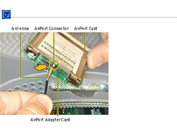

    • With a flathead screwdriver or coin, turn the colored latch to open the access door. The antenna and AirPortCard will be visible when you open the access door.
    • If the AirPort card is not installed, a clear protective antenna cap will be attached to the antenna.
    • Remove the AirPort Card by lifting the card straight up and out of the card guides and connector.
    • Disconnect the antenna from the small hole AirPort Card.
