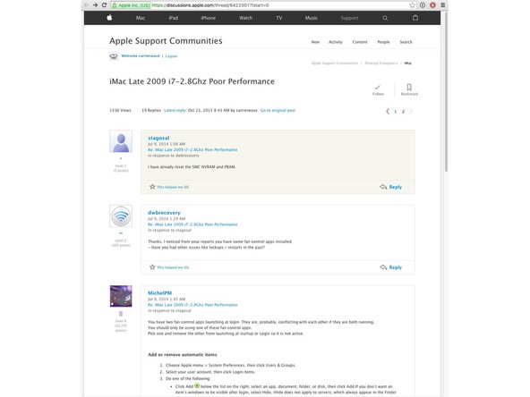

  2. iMac 27" Late 2009 Intel Processor Replacement (EMC 2374), Slow performance: crwdns2935265:02crwdnd2935265:01crwdnd2935265:01crwdne2935265:0
    • Geekbench 3 32-bit test. Geekbench 3 allows you to browse results from others with similar computers, so it was easy to see that something was wrong with my mine.
  3. iMac 27" Late 2009 Intel Processor Replacement (EMC 2374), Ask for help: crwdns2935265:03crwdnd2935265:01crwdnd2935265:02crwdne2935265:0 iMac 27" Late 2009 Intel Processor Replacement (EMC 2374), Ask for help: crwdns2935265:03crwdnd2935265:02crwdnd2935265:02crwdne2935265:0
    • Naturally I asked on the iFixit forums and elsewhere about what might be wrong. Though helpful, the forums spun off in irrelevant directions, mostly talking about hard drive install issues. Geekbench 3 dosen't benchmark hard drives so...
