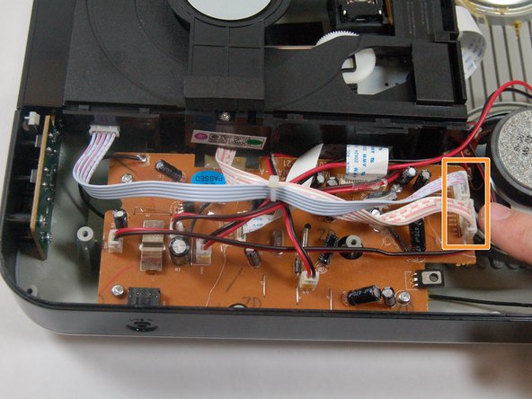

  4. iLive IKBC384S Motherboard Replacement, Motherboard: crwdns2935265:04crwdnd2935265:01crwdnd2935265:01crwdne2935265:0
    • After removing the top of the device, locate the screws on the motherboard. Gently unscrew all four of the 3.5mm screws on the motherboard.
  5. iLive IKBC384S Motherboard Replacement: crwdns2935265:05crwdnd2935265:01crwdnd2935265:02crwdne2935265:0 iLive IKBC384S Motherboard Replacement: crwdns2935265:05crwdnd2935265:02crwdnd2935265:02crwdne2935265:0
    • Unplug the ribbon cable connected to the motherboard that stems from the disc drive.
    • Disconnect the two power connectors from the motherboard.
  6. iLive IKBC384S Motherboard Replacement: crwdns2935265:06crwdnd2935265:01crwdnd2935265:01crwdne2935265:0
    • You will need to desolder the antenna.
    • Be sure to desolder the piece connected to the motherboard not the wire.
  7. iLive IKBC384S Motherboard Replacement: crwdns2935265:07crwdnd2935265:01crwdnd2935265:01crwdne2935265:0
    • You will need to remove the speakers and power connector.
    • Once you have removed all of these from the motherboard, the motherboard can be removed
