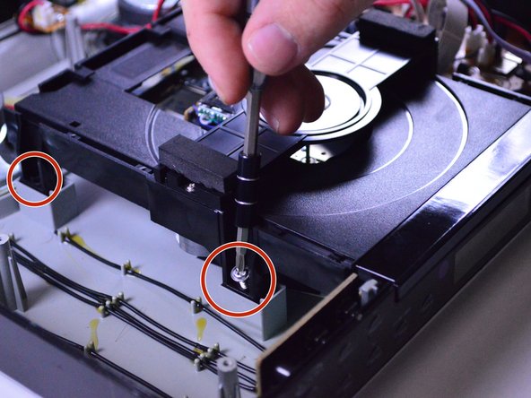

  4. iLive IKBC384S Disk Drive Replacement, Disk Drive: crwdns2935265:04crwdnd2935265:01crwdnd2935265:02crwdne2935265:0 iLive IKBC384S Disk Drive Replacement, Disk Drive: crwdns2935265:04crwdnd2935265:02crwdnd2935265:02crwdne2935265:0
    • Remove all four screws(13.5 mm in length) that are securing the device

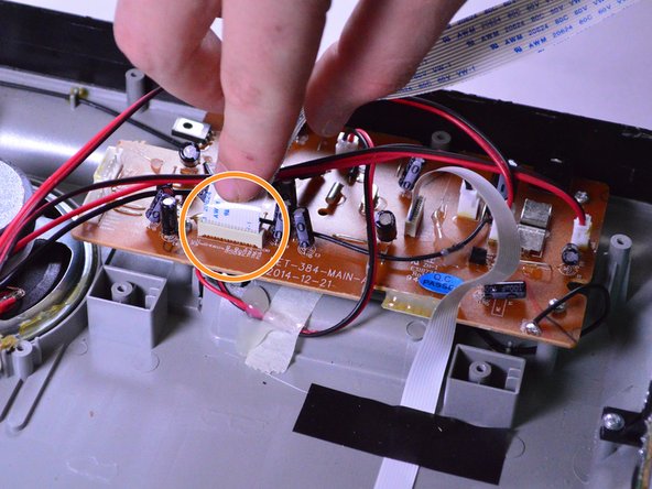

  5. iLive IKBC384S Disk Drive Replacement: crwdns2935265:05crwdnd2935265:01crwdnd2935265:02crwdne2935265:0 iLive IKBC384S Disk Drive Replacement: crwdns2935265:05crwdnd2935265:02crwdnd2935265:02crwdne2935265:0
    • Remove both of the connected cords on the motherboard.
    • Also remove the flat ribbon cable that is connected to the motherboard.
    • Once you have removed all screws and cables connected to motherboard the disk drive can be easily removed
