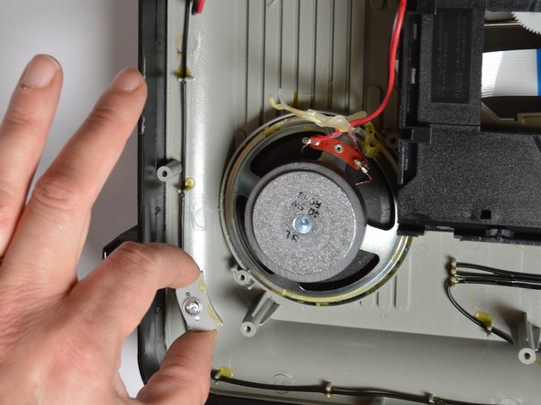

  4. iLive IKBC384S Audio Speakers Replacement, Audio Speakers: crwdns2935265:04crwdnd2935265:01crwdnd2935265:02crwdne2935265:0 iLive IKBC384S Audio Speakers Replacement, Audio Speakers: crwdns2935265:04crwdnd2935265:02crwdnd2935265:02crwdne2935265:0
    • Be sure to unscrew (3 mm) the two plastic brackets on each speaker, use iOpener or heat gun they are glued onto speakers, please do not discard.
  5. iLive IKBC384S Audio Speakers Replacement: crwdns2935265:05crwdnd2935265:01crwdnd2935265:01crwdne2935265:0
    • Unplug both of the speakers from the motherboard.
