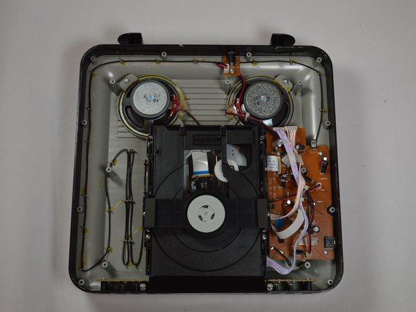

    • Make sure you remove all seven 3 mm screws before proceeding to the next step.
  2. iLive IKBC384S  FM/AM Antenna Replacement: crwdns2935265:02crwdnd2935265:01crwdnd2935265:02crwdne2935265:0 iLive IKBC384S  FM/AM Antenna Replacement: crwdns2935265:02crwdnd2935265:02crwdnd2935265:02crwdne2935265:0

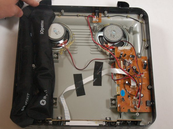

    • Use iOpener or heat gun on all sides except the front.
  3. iLive IKBC384S  FM/AM Antenna Replacement: crwdns2935265:03crwdnd2935265:01crwdnd2935265:02crwdne2935265:0 iLive IKBC384S  FM/AM Antenna Replacement: crwdns2935265:03crwdnd2935265:02crwdnd2935265:02crwdne2935265:0
    • Be cautious when taking the top of the device off there may still be some adhesive stuck to device.
    • The top of the device will be very difficult to remove because of the adhesive holding it together.

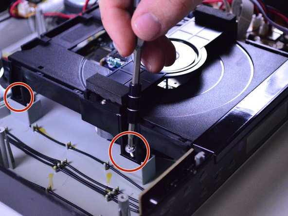

  4. iLive IKBC384S  FM/AM Antenna Replacement, FM/AM Antenna: crwdns2935265:04crwdnd2935265:01crwdnd2935265:02crwdne2935265:0 iLive IKBC384S  FM/AM Antenna Replacement, FM/AM Antenna: crwdns2935265:04crwdnd2935265:02crwdnd2935265:02crwdne2935265:0
    • Remove all four screws(13.5 mm in length) that are securing the disk drive.

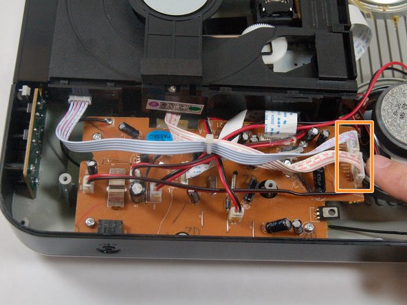

  5. iLive IKBC384S  FM/AM Antenna Replacement: crwdns2935265:05crwdnd2935265:01crwdnd2935265:02crwdne2935265:0 iLive IKBC384S  FM/AM Antenna Replacement: crwdns2935265:05crwdnd2935265:02crwdnd2935265:02crwdne2935265:0
    • Unplug the ribbon cable connected to the motherboard that stems from the disc drive.
    • Also, disconnect the two power connectors from the motherboard.
    • Once you have removed the ribbon cables and two connectors on the motherboard the disk drive can be removed.

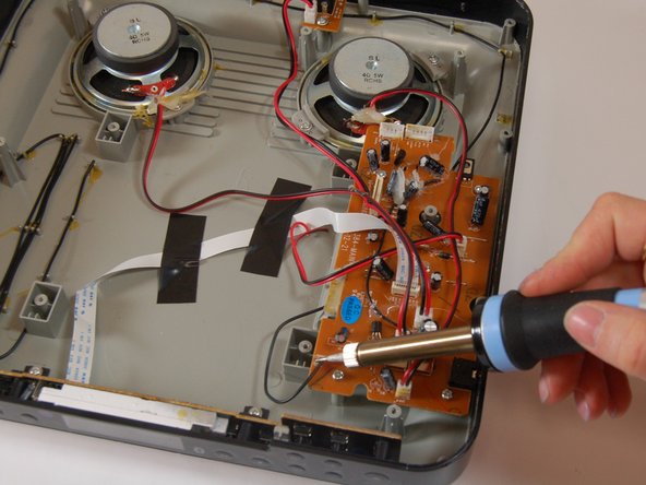

  7. iLive IKBC384S  FM/AM Antenna Replacement: crwdns2935265:07crwdnd2935265:01crwdnd2935265:02crwdne2935265:0 iLive IKBC384S  FM/AM Antenna Replacement: crwdns2935265:07crwdnd2935265:02crwdnd2935265:02crwdne2935265:0
    • Desolder the antenna at the contact point.
    • Check out this awesome guide for soldering and desoldering tips.
  8. iLive IKBC384S  FM/AM Antenna Replacement: crwdns2935265:08crwdnd2935265:01crwdnd2935265:02crwdne2935265:0 iLive IKBC384S  FM/AM Antenna Replacement: crwdns2935265:08crwdnd2935265:02crwdnd2935265:02crwdne2935265:0
    • Place iOpener on antenna for approximately 5 minutes
  9. iLive IKBC384S  FM/AM Antenna Replacement: crwdns2935265:09crwdnd2935265:01crwdnd2935265:01crwdne2935265:0
    • Lift up and remove all of the antenna.
    • The antenna will be glued down all the way around the radio
