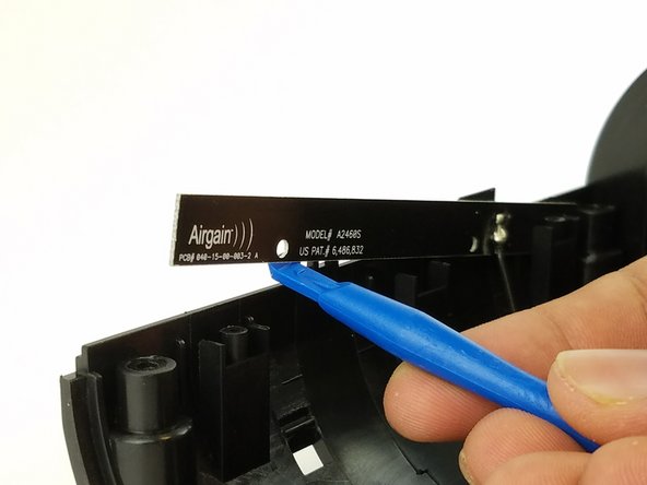

    • Pry the glue and unclip the wifi antenna plug from the circuit board.
  16. iHome iW1 Speaker Wi-Fi Antennae  Replacement, Wi-Fi Antennae: crwdns2935265:016crwdnd2935265:01crwdnd2935265:02crwdne2935265:0 iHome iW1 Speaker Wi-Fi Antennae  Replacement, Wi-Fi Antennae: crwdns2935265:016crwdnd2935265:02crwdnd2935265:02crwdne2935265:0
    • Remove the wifi antenna from the side of the speaker by sliding it upward with a plastic spudger.
