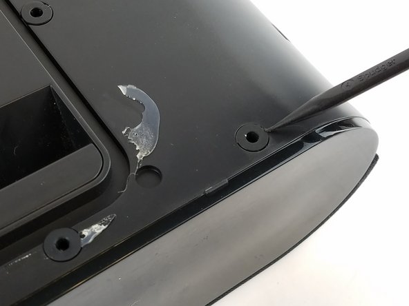

    • Remove the rubber from the bottom of the speaker, use a medium blue plastic spudger to gently work its way under the rubber and slowly peel off for each of the three feet. The order does not matter.

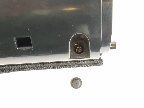

    • Remove the six 11 mm Philips #1 screws found underneath the foam to remove the steel outer metal frame.
    • Once the screws come off, keep them safely off to the side.

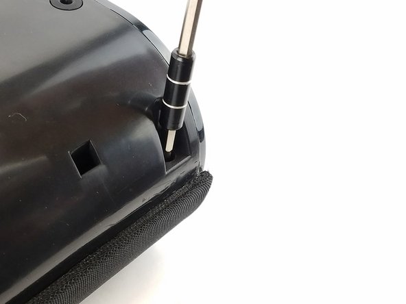

  4. iHome iW1 Speaker Wi-Fi Adapter Replacement: crwdns2935265:04crwdnd2935265:01crwdnd2935265:02crwdne2935265:0 iHome iW1 Speaker Wi-Fi Adapter Replacement: crwdns2935265:04crwdnd2935265:02crwdnd2935265:02crwdne2935265:0
    • Remove the two remaining 11 mm Philips #1 screws holding the base and set them aside.

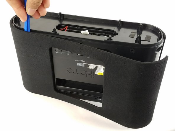

  7. iHome iW1 Speaker Wi-Fi Adapter Replacement, Wi-Fi Adapter: crwdns2935265:07crwdnd2935265:01crwdnd2935265:03crwdne2935265:0 iHome iW1 Speaker Wi-Fi Adapter Replacement, Wi-Fi Adapter: crwdns2935265:07crwdnd2935265:02crwdnd2935265:03crwdne2935265:0 iHome iW1 Speaker Wi-Fi Adapter Replacement, Wi-Fi Adapter: crwdns2935265:07crwdnd2935265:03crwdnd2935265:03crwdne2935265:0

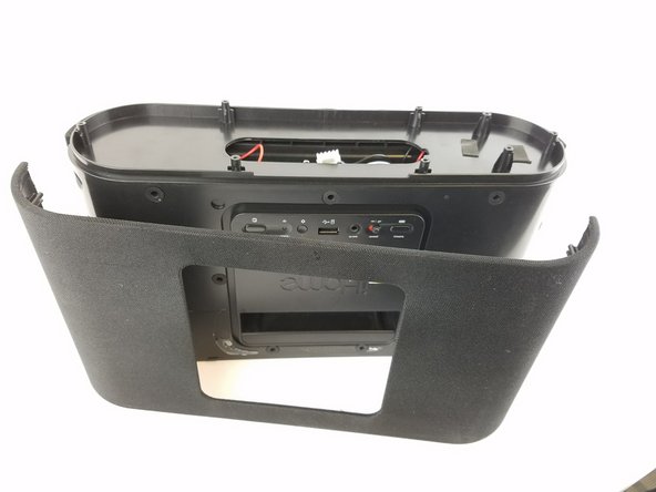

    • Pry off the mesh frame from the back side of the speaker with a plastic spudger until you hear a click noise when the clip is removed.

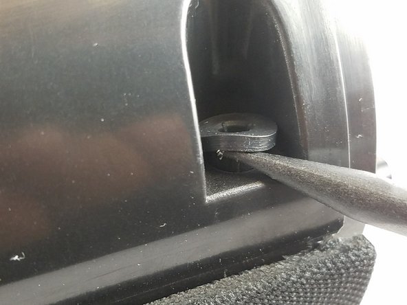

    • Use a plastic spudger to remove the rubber grommets from the four corners of the speaker underneath the mesh frame.
  9. iHome iW1 Speaker Wi-Fi Adapter Replacement: crwdns2935265:09crwdnd2935265:01crwdnd2935265:03crwdne2935265:0 iHome iW1 Speaker Wi-Fi Adapter Replacement: crwdns2935265:09crwdnd2935265:02crwdnd2935265:03crwdne2935265:0 iHome iW1 Speaker Wi-Fi Adapter Replacement: crwdns2935265:09crwdnd2935265:03crwdnd2935265:03crwdne2935265:0
    • Remove the four 11 mm Philips #1 screws from beneath the rubber grommet that was removed from the previous step in all four corners.

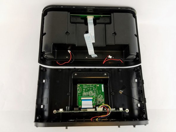

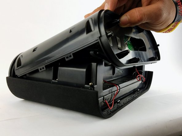

    • Separate the mesh frame and plastic frame by placing the spudger in between them.
    • Do not pull the two pieces since the two pieces are held together with the ribbon cable.

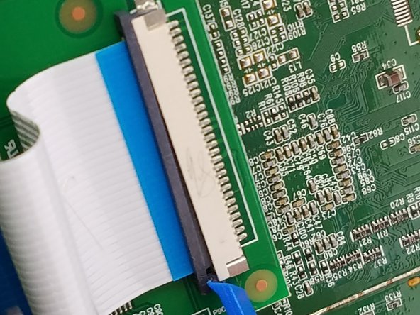

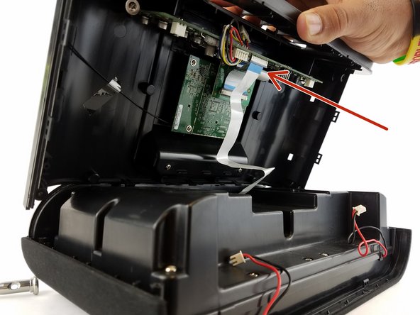

  11. iHome iW1 Speaker Wi-Fi Adapter Replacement: crwdns2935265:011crwdnd2935265:01crwdnd2935265:03crwdne2935265:0 iHome iW1 Speaker Wi-Fi Adapter Replacement: crwdns2935265:011crwdnd2935265:02crwdnd2935265:03crwdne2935265:0 iHome iW1 Speaker Wi-Fi Adapter Replacement: crwdns2935265:011crwdnd2935265:03crwdnd2935265:03crwdne2935265:0

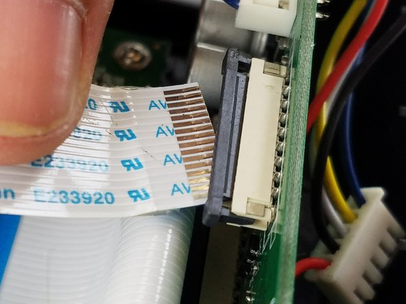

    • Remove the ribbon cable by pulling the black clip towards the cable, then gently pull the ribbon cable to fully separate the mesh frame and plastic frame.
    • The black locking clip will only move about 2mm out.
  12. iHome iW1 Speaker Wi-Fi Adapter Replacement: crwdns2935265:012crwdnd2935265:01crwdnd2935265:03crwdne2935265:0 iHome iW1 Speaker Wi-Fi Adapter Replacement: crwdns2935265:012crwdnd2935265:02crwdnd2935265:03crwdne2935265:0 iHome iW1 Speaker Wi-Fi Adapter Replacement: crwdns2935265:012crwdnd2935265:03crwdnd2935265:03crwdne2935265:0

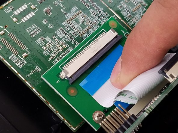

    • Remove the second ribbon cable that is connected to the main circuit board and the WiFi adapter.

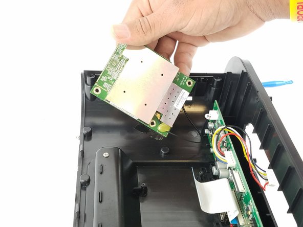

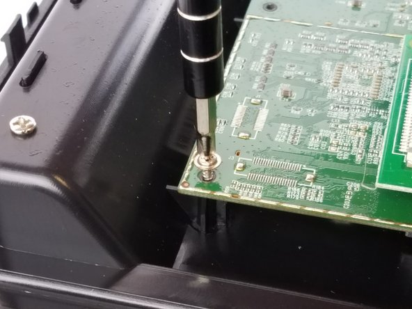

  13. iHome iW1 Speaker Wi-Fi Adapter Replacement: crwdns2935265:013crwdnd2935265:01crwdnd2935265:03crwdne2935265:0 iHome iW1 Speaker Wi-Fi Adapter Replacement: crwdns2935265:013crwdnd2935265:02crwdnd2935265:03crwdne2935265:0 iHome iW1 Speaker Wi-Fi Adapter Replacement: crwdns2935265:013crwdnd2935265:03crwdnd2935265:03crwdne2935265:0

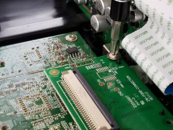

    • Unscrew the five 11 mm Philips #1 screws found on the outside of the circuit board.
  14. iHome iW1 Speaker Wi-Fi Adapter Replacement: crwdns2935265:014crwdnd2935265:01crwdnd2935265:02crwdne2935265:0 iHome iW1 Speaker Wi-Fi Adapter Replacement: crwdns2935265:014crwdnd2935265:02crwdnd2935265:02crwdne2935265:0
    • Lift the circuit board to expose the wifi antenna wire.

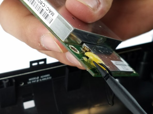

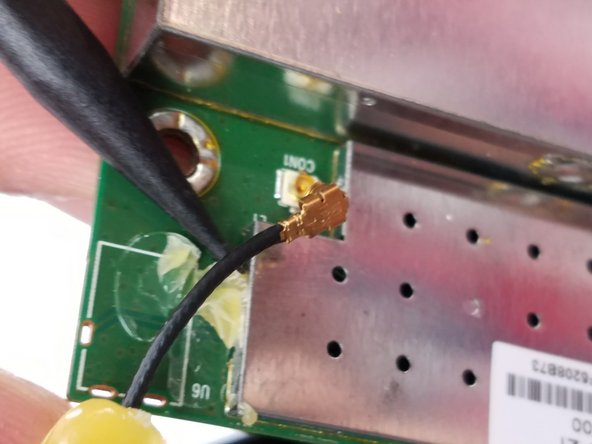

  15. iHome iW1 Speaker Wi-Fi Adapter Replacement: crwdns2935265:015crwdnd2935265:01crwdnd2935265:03crwdne2935265:0 iHome iW1 Speaker Wi-Fi Adapter Replacement: crwdns2935265:015crwdnd2935265:02crwdnd2935265:03crwdne2935265:0 iHome iW1 Speaker Wi-Fi Adapter Replacement: crwdns2935265:015crwdnd2935265:03crwdnd2935265:03crwdne2935265:0
    • Pry the glue and unclip the wifi antenna plug from the circuit board.
